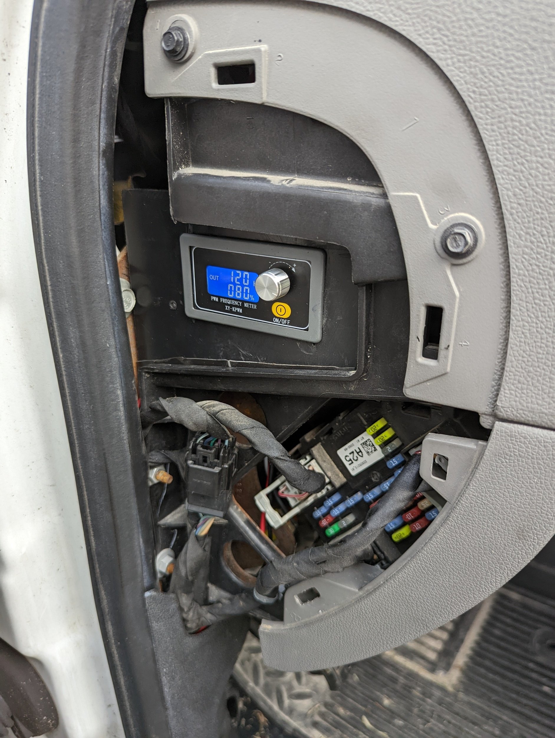

Depends on the year but the pcm bypass for my 2013 was simple enough.
Depends on the year but the pcm bypass for my 2013 was simple enough.View attachment 46034View attachment 46035View attachment 46036View attachment 46037
