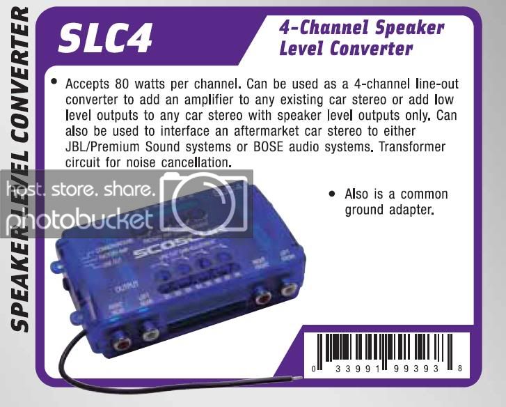

ok, so check ground and also, does the line converter have to be grounded? it has a wire comming off but i'm not sure what it is. thanks for the help
Can you take a pic if possible of the line converter? Or what model are you using?
Almost positive it is a grounding issue though. Check all the grounds, make sure you have sanded any paint off and that it is secure.

I had this problem before. I had to switch from LOC to the LOC on the JBL amp I have. And it was grounded properly. I think you are right about the speaker movement being transferred to electrical energy from the coil moving, but I could be wrong. Initially that is what I chalked it up to.
I've had this happen before to me using the same equipment. What do you have the remote wire for the amp hooked up to? The issue I had was that the amp was getting power but was not getting a signal from the LOC to process. Find a better remote source that turns off with the radio. Also with my punch amp if I left my bass remote turned up and turned my radio off causing my amp to stay on and not have a signal coming from the LOC it would cause my sub to make a constant rumble.
