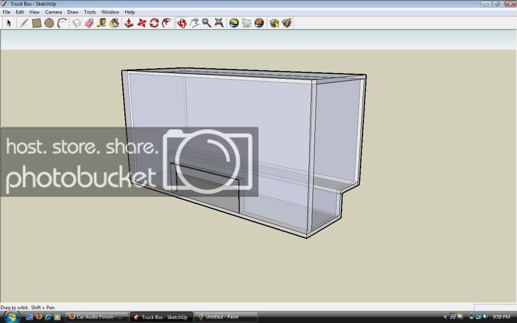

I guess my box isn't "weird" but i'm stuck on what i nee to do tuning wise.
my box is a smaller version of this...
see how it rises up in the back? I'm changing the box plans to be 51 wide x 15 tall x 14 deep. I'm also making the port 5 inches wide and 13.5 tall, so it will go to the top of the box...
BUT my box rises up 5 inches in the back...how do i compensate for this??
The port needs to be 22.2 inches long BTW---ninja edit FTW!
instead of actually following the bottom of the box, put a 45 in the port, to make it clear that back bump, then 45 it again up the back wall until you get to your desired length.
Or just put the port on the top (As long as it fits between the subs) and 90 it down the back wall
