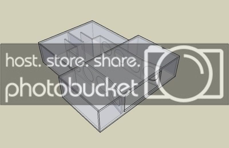

Well it wont sound very good with the subs outside. You can use Pro Audio type drivers and build a box similar to concert speakers. But Car audio subs are designed to be used in confined spaces and can actually be damaged when used outside.
Build a bandpass out of wood, then coat the entire enclosure in fiberglass. Since it is a bandpass, the sub itself will not be exposed to the weather.
BTW, this was done alot in the 80s and is still done alot in Japan and south america.
