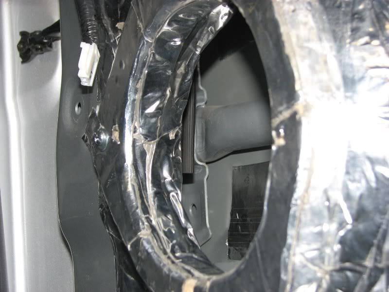

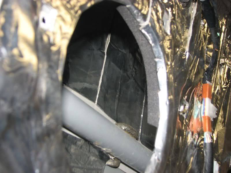

if you use the foam baffle, you need to cut out the bottom half.
as mentioned, water gets in all doors. that's why you have a plastic sheet in there, and why factory speakers have mounting cradles.
the water is running down the inside of the door metal. if you give the water a channel to go around, you can usually keep your speaker dry. you can achieve this with weatherstripping foam and/or deadener to create a lip around the top half of the opening.
3/4" closed cell weatherstripping foam:
BXT II over the seam and foam to increase the lip:
Fucking genius bro. //content.invisioncic.com/y282845/emoticons/imdaman.gif.bc6c552e19aa4ad8c47461144f40eb1a.gif
XTC baffles are fine, just recognize they are deeper than the window usually allows and you don't want to leave them enclosed. the speaker needs airspace and closed cell foam doesn't breathe. use the XTC baffle but cut out the bottom half and back as required for depth.
