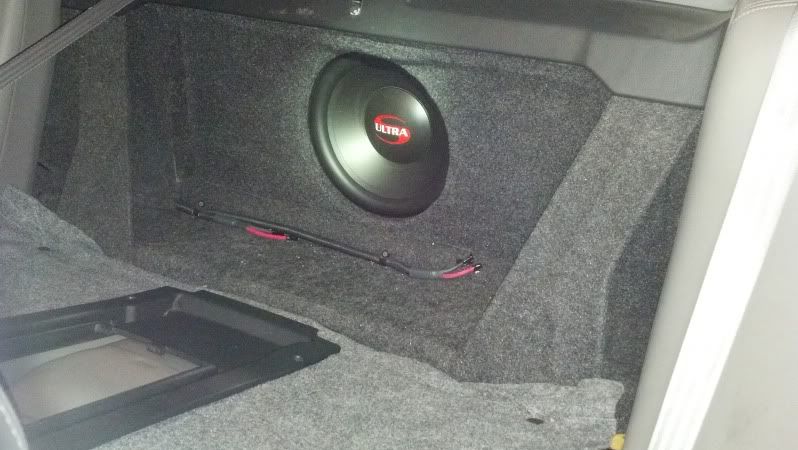

Look for KHA's 2001 Accord build log. His pictures go through the steps he went through to make his system IB. Of course, in typical KHA fashion, he goes WAY above and beyond what most installers would do. Here's an example of his IB setup:

Refer to my above post with pictures. As for getting the cutouts made, just do a mockup with cardboard and take it somewhere that will cut for you or ask a buddy/local shop to cut the shapes and just pay them a 20

Oh OK I see what you mean now. I don't think that's going to be an option for me. Looks expensive as hell to make it look good :p and also I have no blow through port in my car like he does to make that work the way his did
