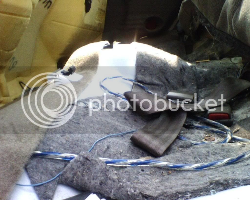

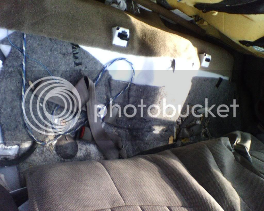

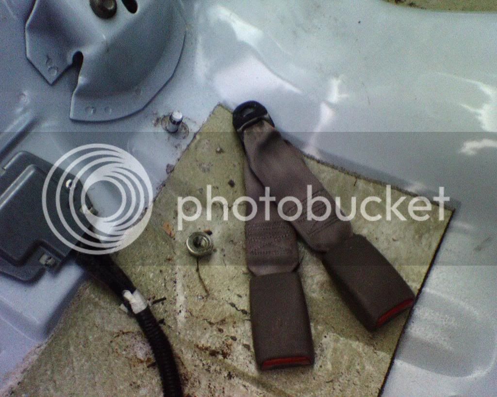

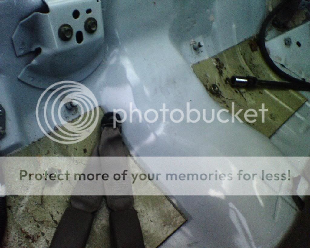

It is a 4door and I figured that was the best I can do. Here are some pictures...
heres what i would do...
for the back, get you some metal, thicker metal...not plumbers strap. make it come down from your seat belt, and put a bolt through that. here's a pic, you should be able to tell from that. back ones from seat belt down, and the front, put the bolt right in the corner, gas tank doesn't go all the way to the corner. i would get a nut and bolt, weld the nut to the floor( you know, pull the carpet back, then cover it back up. w/ a little slit in the carpet) here is a crappy paint pic. here is a quick legend:
red= metal
yellow= wood/gas
blue=nut/bolt
black=car
the nut welded to the floor, the bolt the metal to the nut. i would screw 2 pieces of wood together for the dancefloor, that way you could countersink the nuts. (the small pic in the corner is a close up of the welded bracket.
if you use liquid nails in the front, and run the dance floor all the way to the back of the botom of the trunk (2 piece it if you have too) and run some bolts through, you will be fine.
plumbers strap wont do anything but snap and probably come flying at you after the wall has smashed you.
IIRC when i had my G/A apart the floor of the trunk sits up QUITE a bit higher than the front, i believe if he was to do that he would end up w/ a bit of an angle for the dance floor. if you had the resources. i'd drop the tank and run some bolts up from the bottom. than put the tank back in...but i know not everyone can drop a tank //content.invisioncic.com/y282845/emoticons/frown.gif.a3531fa0534503350665a1e957861287.gif
