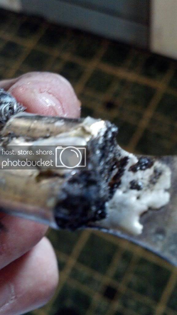

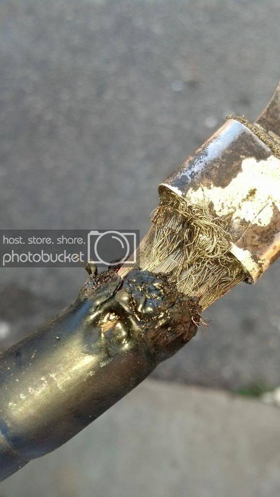

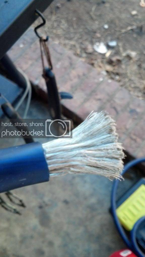

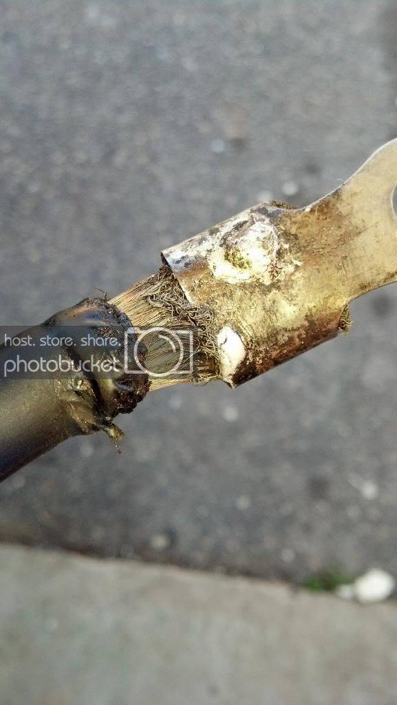

Well i think solved the problem. The guy i had do it had burnt the holy **** out of the wires where they were crimped, and the crimps on one of the wires came off with me pulling on it. Was dipping into low 11s and never really got above 13 with the big 3 done, with stock wires the lowest my voltage dropped was 12.8 and was above 14 90% of the time. I mean one of the ground wires, and the wire going to the positive terminal from the fuse holder, couldnt even keep the jacket on. I was trying to pull the rubber boot back and the jacket was sliding with it. About 3 inches on all the wires except one were a darker brown from burning where he "soldered" it. And the wire in the crimps were black, i could rub on them a bit and they would start breaking. Ill throw up some pics in a sec

what the wire looked like after he torched the holy ******* hell out of it

These are what the wire looked like about 3 inches under the jacket on either said of the wire
