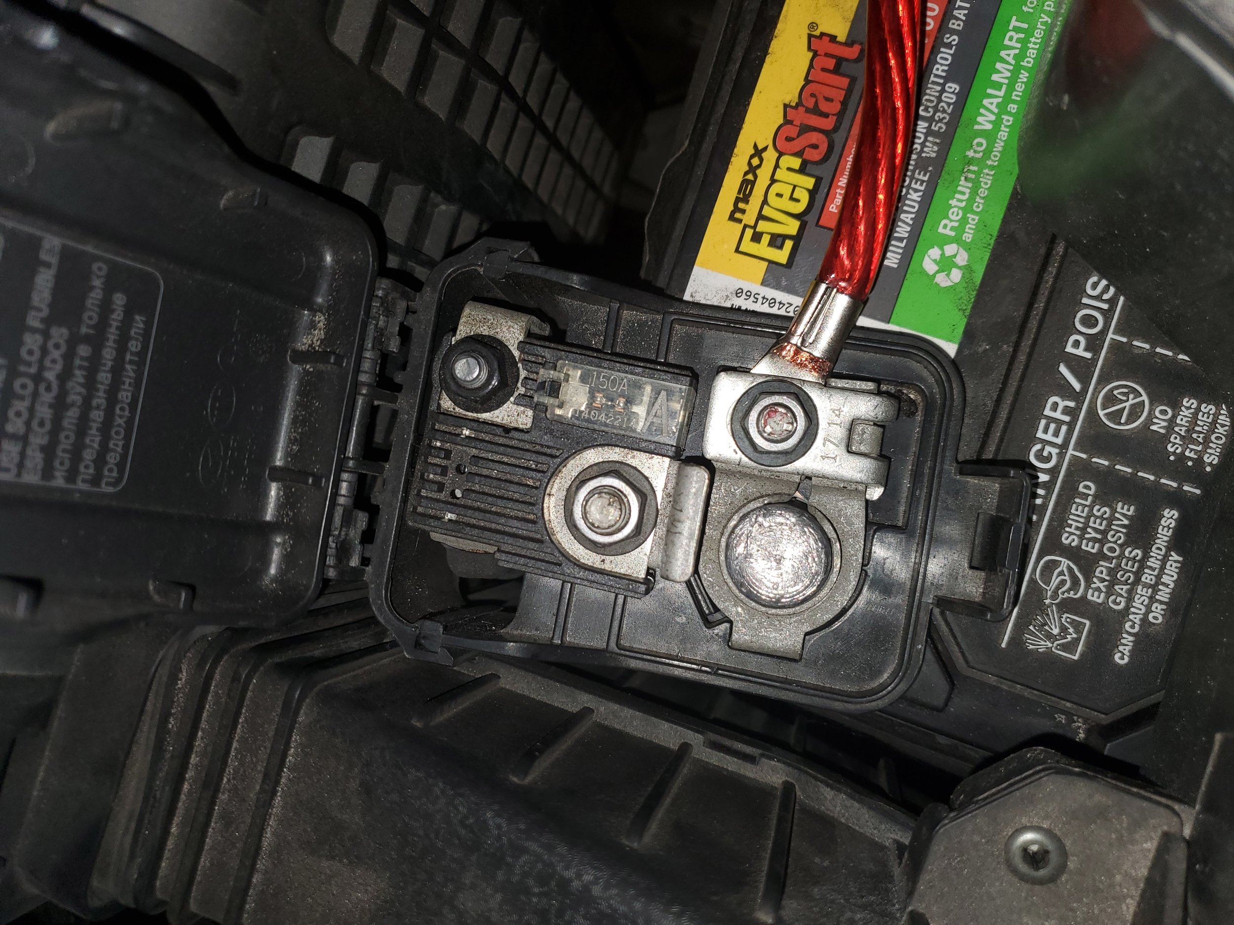

Also my battery terminal has a 150 amp fuse on it. Pictures attached.

So I would not want to install my amp wire on that or are you saying it shouldn't have any negative effect on it?
It does nothing for your amps power wire it's not even connected to the fuse. That fuse is for the oem wiring going to the fuse box.
Does your power wire not have the 80 amp included fuse inline?
But doesnt really matter. That wire should be pulled out ASAP.

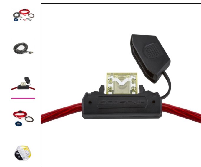

I recommend this kit.

Ok for sure I'll yank it out and I'm gonna go get a 0 Guage kit from my local store. Seriously don't know what I would do without you guys. Thanks! You ROCK!
