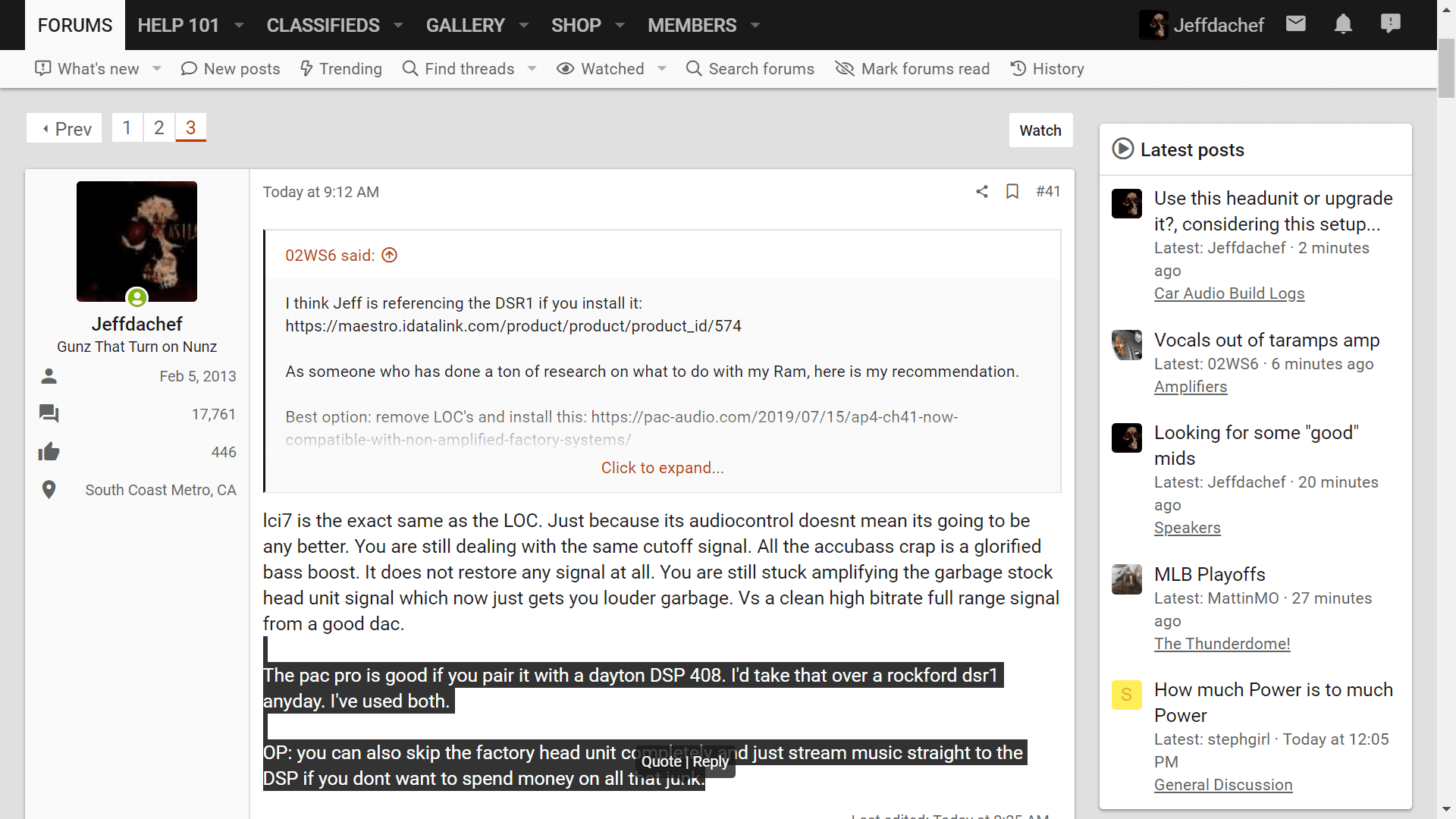

So that's your 2nd best recommendation? Even though you just shit all over it? or are you referencing:
No one is arguing an aftermarket HU wouldn't be better. It will and I'm saying you're right! I'm also telling you as an owner, what is practical and usable for other 2013+ FCA owners. You may consider it "shit" and for someone with your experience and your sig build, I can see why you'd think that. What I'm saying is there are thousands if not 10's of thousands of FCA owners running AP4's, LCi's or DSR's and are quite happy with them. From shitbox 20k Renegades to 100k SRT Hellcats.
oops i actually put the other comment inside my comment its the last parts literally anything the pac or the maestro over another audiocontrol crap product. Those products actually just get a flat unadulterated signal to your processing. I trashed the dsr1 for a good reason my group and I were the earliest adopters and that was a whole year of buggy *** bluetooth connection and software bugs. Definitely the pac pro plus a dayton DSP over all that headache or skip the head unit altogether. Meaning just play music straight to the USB dongle on the dayton. Cleanest signal you can get. All the tuning is on your phone app. No need to mess with the factory head unit or take it out or anything. Just need to wire your whole audio system to your amps, and straight to your dsp.

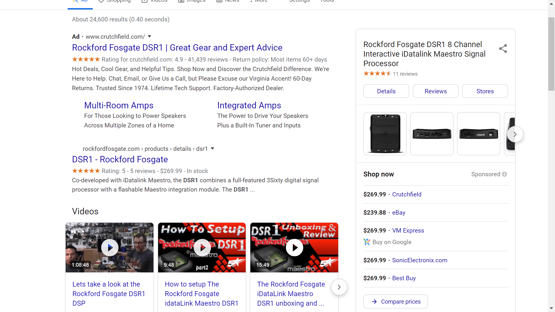

So the dsr1 with meastro harness will do the trick right? It's that or the Dayton ? Which idk what the Dayton even is but the maestro and dsr1 will cost me about 300 usd .

I'd defiintely go with the pac pro with dayton dsp over the dsr1. Dayton DSP is vastly superior to the rockford dsr1 never had a single issue like I did with the dsr1.
Ahh I see it on your previous comment now (y) - PAC with Dayton 408 - I agree.

No, consensus I believe is PAC AP4 Amp Pro with a Dayton DSP 408. Run that to your amps. (Jeff, fee free to correct me If I got that wrong)
Cleanest possible signal would then be to connect your phone directly to the DSP 408 and play music from there. YMMV as I would do something similar but play most stuff through stock HU to keep my SiriusXM and music controls on my steering wheel.

The Dayton dsp 408 is out of my price range so I think I'll go with the dsr1 lol
Start with the PAC AP4 for now then, and get the 408 later when you can afford it. Will be a much better experience than the DSR1 and the Amp Pro is only $10 more.
the dayton is 150 with the pac being 280. The dsr1 is 270 and the idata link maestro is 150 what? 10 dollars more for a much more reliable quality unit with better features and software is out of your price range? You cant just buy the rockford alone, you need the maestro unit for another 150 dude.
I thought the dsr1 was sub 270? Maybe not with the integration harness but sub 200.
I've had little to no issues with my dsr1 since I've had it set up. Getting it set up however, was bullshit.
It's not even 4x8, it's 4x7. They software locked 7/8 to be considered one channel. It's beyond stupid.
oh its 240 on amazon. I just looked on the side after a quick search, didnt really check. Its been awhile since you got yours man, inflation has had plenty of time to kick in :ROFLMAO: :ROFLMAO: :ROFLMAO:
