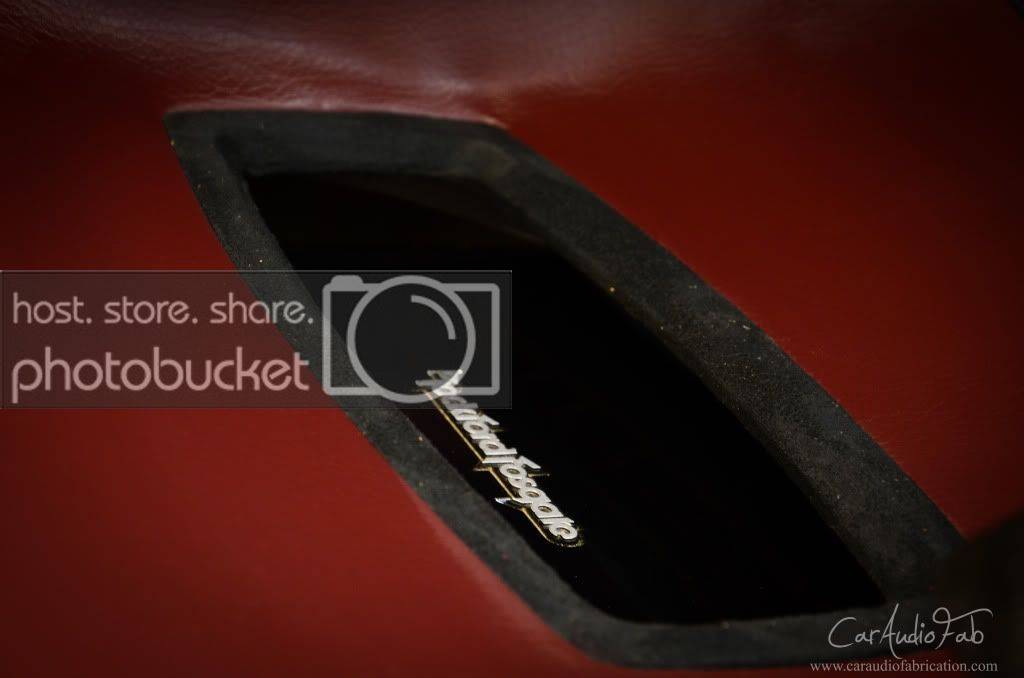

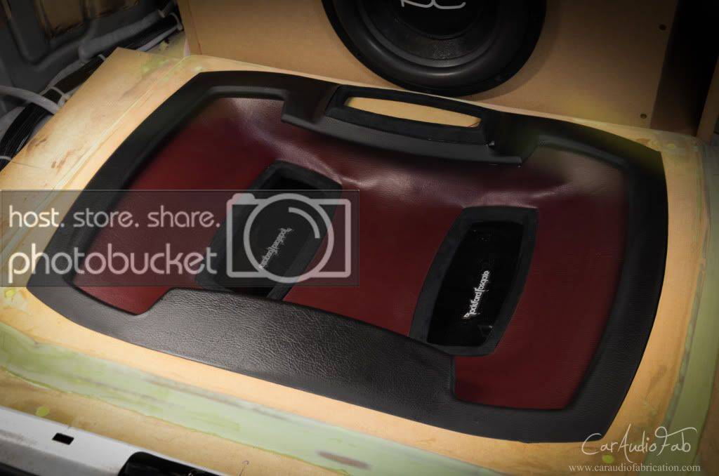

Got the main piece wrapped in vinyl, its glossy looking because I put on Armor-All.
Stay tuned for the video showing how to do this!

Great stuff man!!! When is the next video going to posted up. I am thinking about doing something like this except I will be having a aq3500 for my two twelves a 4 channel for the highs and a battery in the back. Which autocad program were you using so i can try to work some magic? I am not sure whether to have the two amps in my spare tire like you did or have my battery down there and do something else with the amps. I am leaning towards the idea of two amps in spare tire I figure the size diff really wont make a difference since I could cover that up. Keep up the good work
Thanks man, I use SolidWorks. You could always try google sketchup though. If the amps are different sizes I would offset them front to back, if they are side to side I think it would look strange. Covering them up though like I did, but with similar shapes will help you to "link" the two together visually and it will be more appealing.
That's exactly what I was thinking having the big amp in back which is about 25" and front amp in front which is 15" then hopefully fitting the batter right in front of that if it fits. I am going to measure it up and I will let you know what u come up with. I am definitely more confdent now that I have seen your videos
thats what I like to hear man! Thats why I take the time to make all these videos, I want people to learn and take their skills to the next level. Saying I helped someone improve on their install skills is an amazing feeling.
