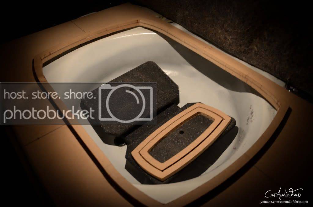

Base board:
In the trunk:
With the inserts so you get the idea...
Alright so I got the amp rack supports complete. This little assembly is strong. And I must say adding the threaded rivets is amazing for mounting the base. To see what I am talking about watch this:
Here's some pics:
Well I decided to go a different route on the templates over the amps. I busted out my Engineering skills and modeled this up on the computer. Check out my "3d amp rack" and let me know what you think.
It;s coming to life! I think its cool how similar to my 3D rendering that it is looking so far! This is just a quick progress update! But I am loving the shape and would love to know what you think!
