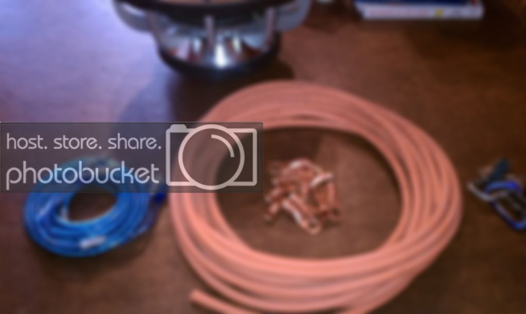

Should be fine you really could get away with 4 awg since it'll be such a short run. wire is normally rated for 25 foot runs anything shorter than that and the rating slowly goes up
Things ive got done.

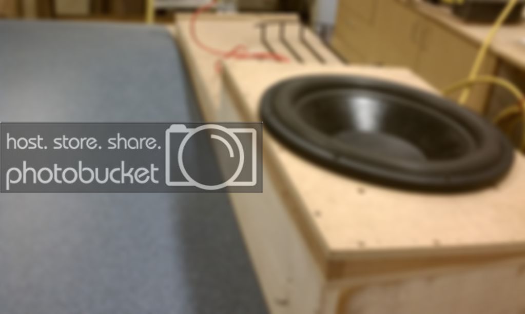

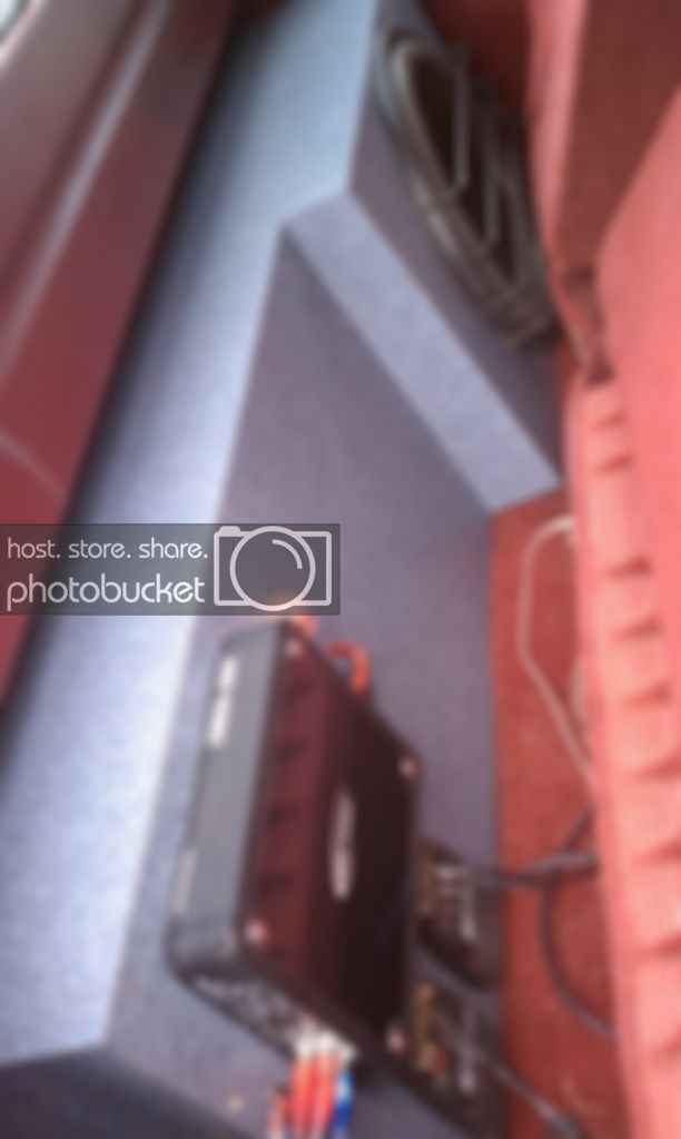

-I finished laminating the box, me and my uncle did it in this blue. I wanted to do black but he didnt want there to be a seam on the top of the box due to the laminate not being long enough. Regardless of the color it turned out really nice, matches the amp kinda, and protects the box while also making it a lot stronger.

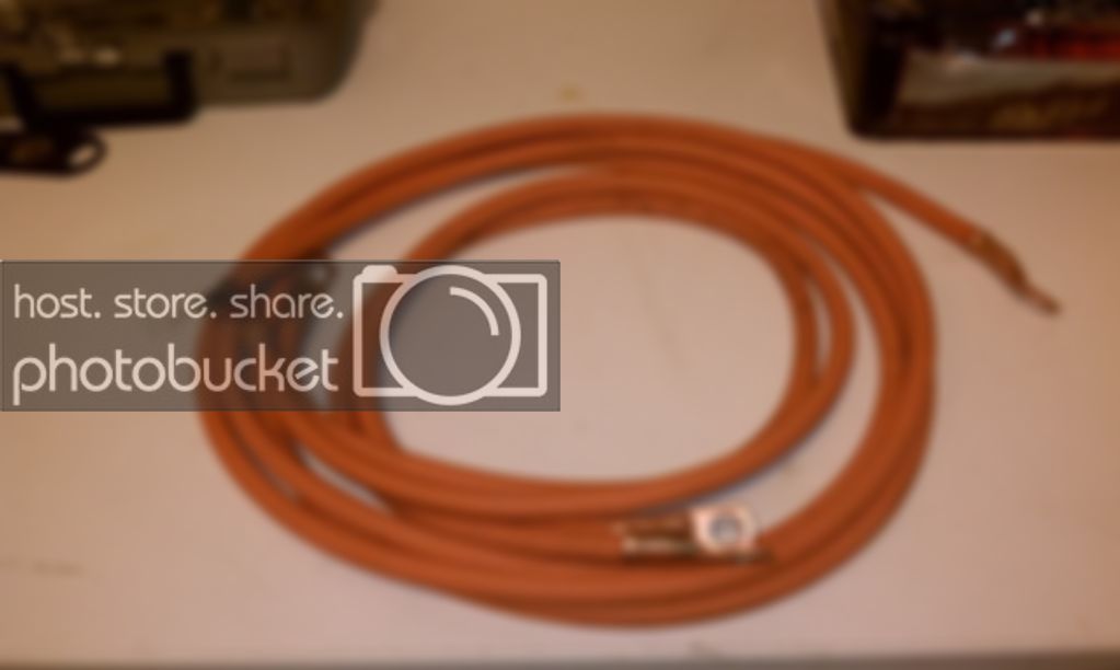

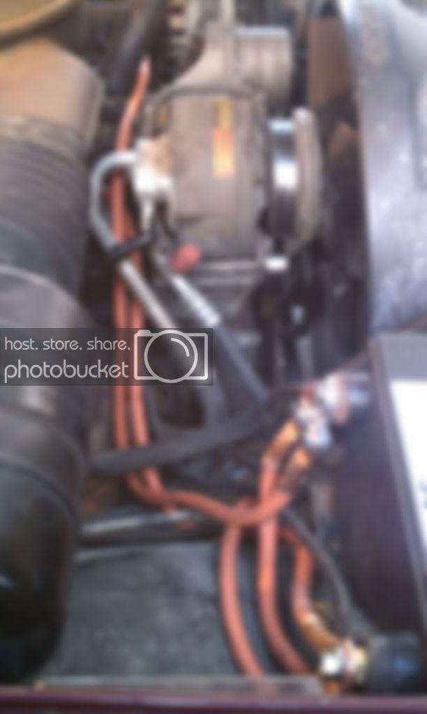

-Finished some big three cables

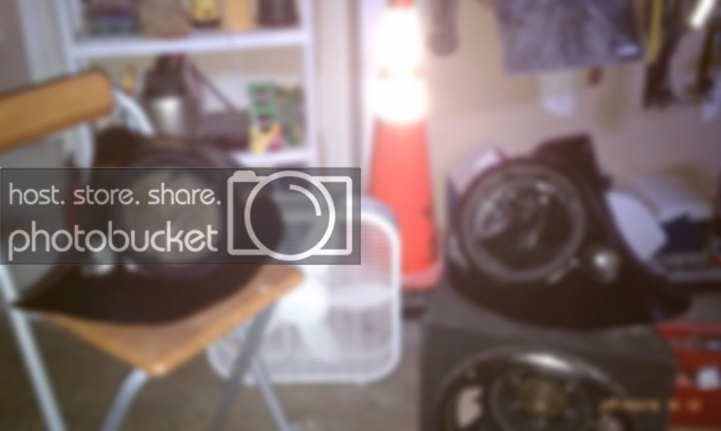

before lamination with the blue laminate we used

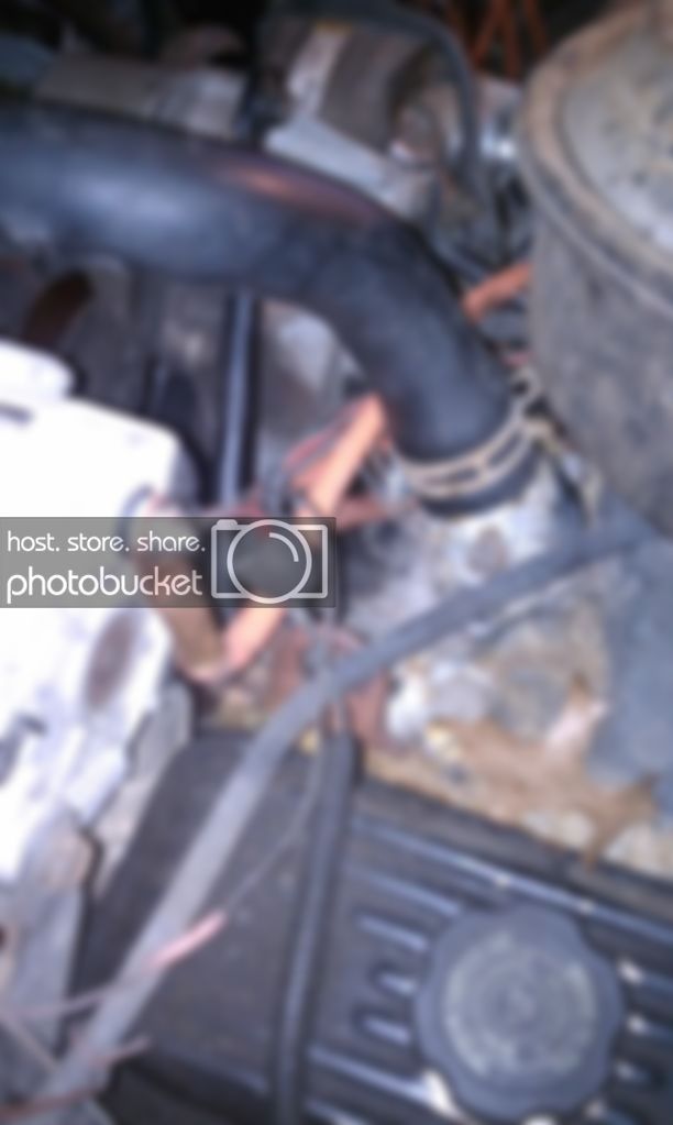

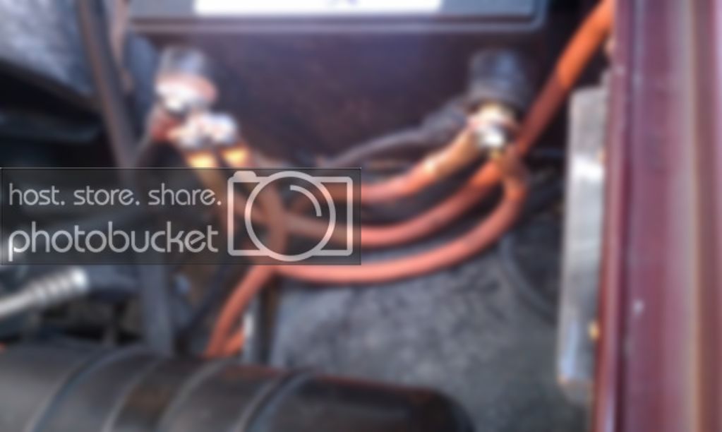

Finally finished the big three upgrade. Battery measured 14.14v idling and amp measured 14.10v dipped down to 14.05v on heavy bass notes. Everything in my truck is brighter the dash and even the headlights. My truck also started quicker as well. voltage before at amp was like 13.7 or something close to that not sure what it was at the battery. Are these new volt readings good or could it get better?

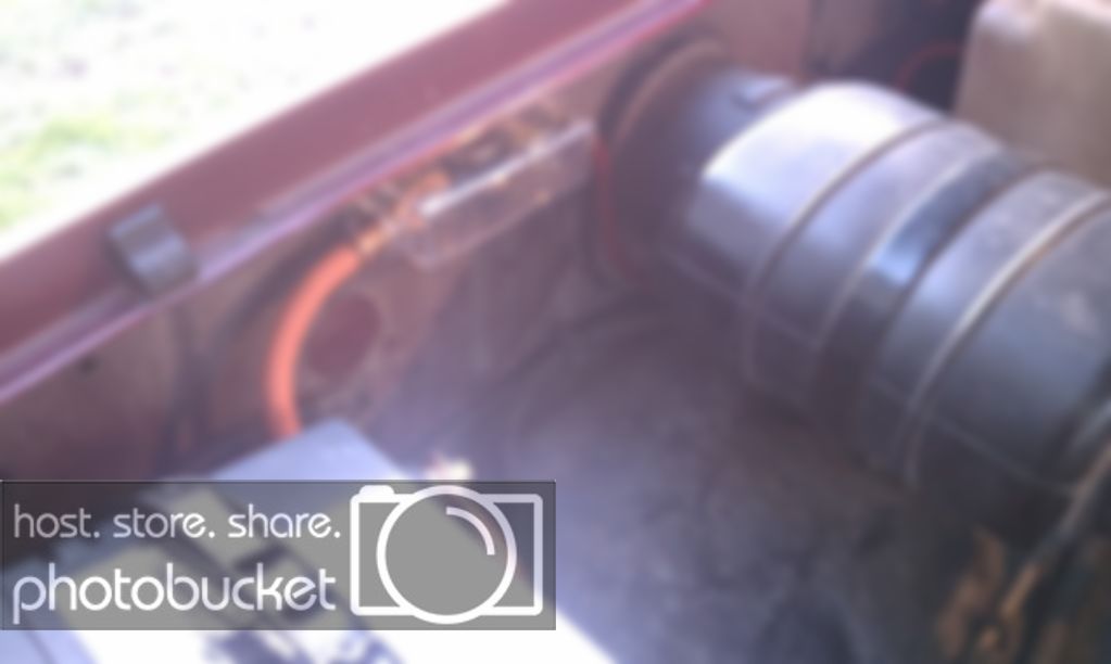

fuse block

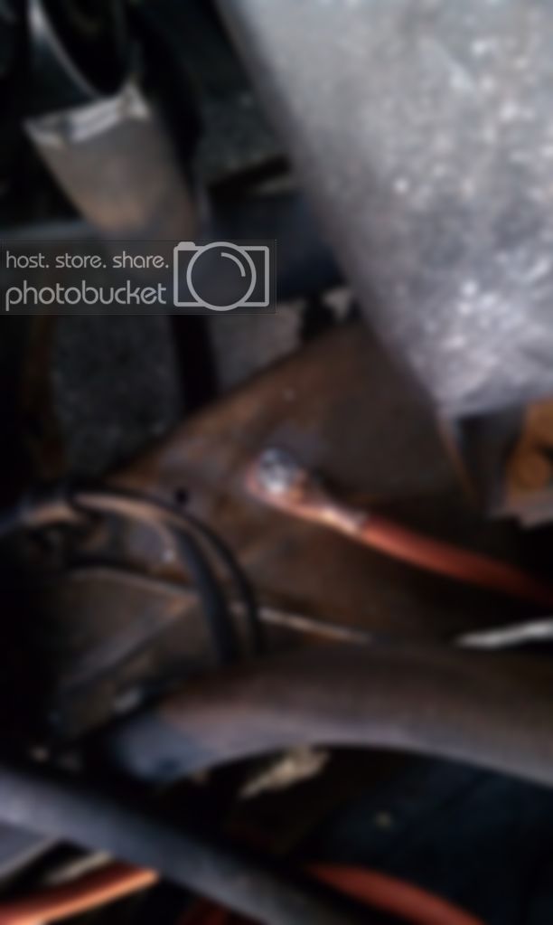

ground
relocated engine ground and also added a run of 2 gauge alongside.
Box is finished besides organizing wires behind the removable amp rack, running 12 gauge speaker wire for everything, and mounting it to the back wall and floor.

Thanks. Laminate is very touch stuff it makes the box a lot stronger and water proof as well as sealing off any leaks. The spray on contact cement is also really strong to. Resists scratches and dings unlike paint. May re laminate in black so it doesn't look like I made a box out out of counter top lol. It still came out nice for being blue.

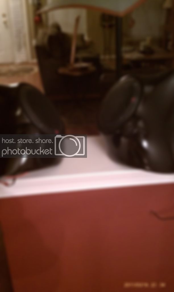

So I finished the kick panels and ran the 12 gauge speaker wire, I finally took the time to mess with them and finish them. took me about a week working on them 3 or so hours a day.
Ill post pics of them installed I just forgot to take them because it is dark.

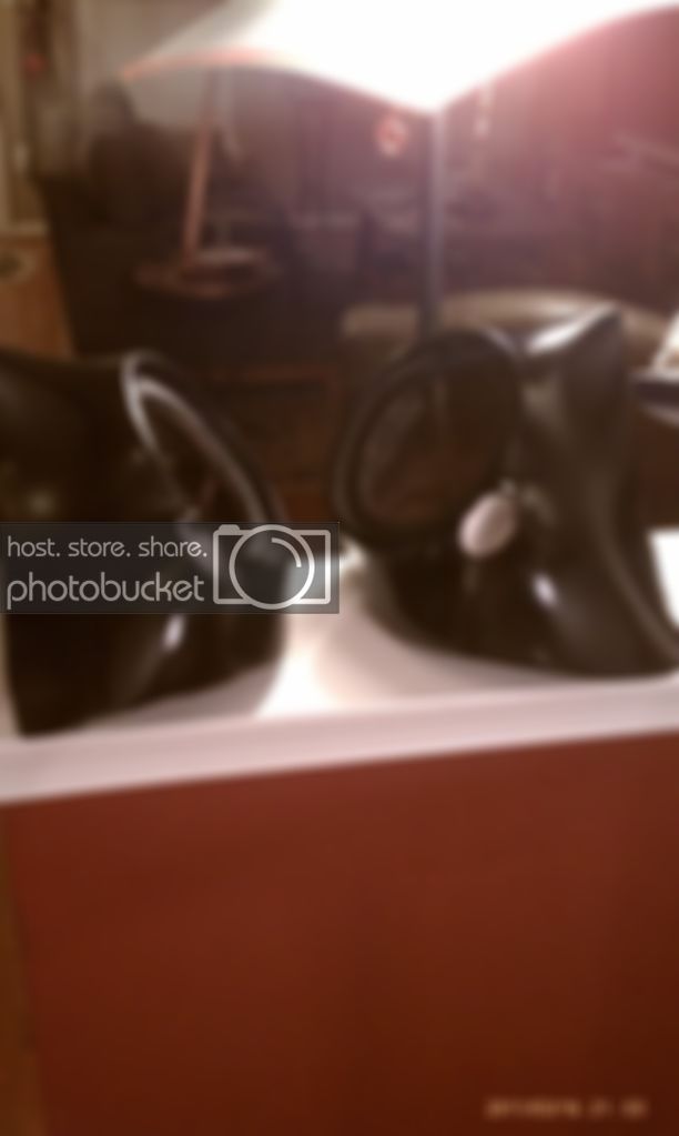

I've got problem with the right woofer being louder then the left so when I sit in the drivers seat with t/a off balance set to equal it all gets dragged to the right. Sounds just like when you use no time alighnment or balance and all the sound appears to only come from the closest speaker. Even sitting on the right side it doesnt switch over to the other side so I know its not the way they are aimed. If I sit dead center of the truck I can fix it with 2 clicks on the balance to the left side. I took some measurements with a multi meter and got 3.5 ohms right side and 3.6 left and on a 1khz tone with volume up a little i got .28 ac volts on one channel and .29 ac volts on the other and this is with balance and ta all off. one side was always a digit higher on the multi meter no matter what the volume.
So hopefully someone can help me find the problem.
I never had this problem when they were free aired temporarely to get the aiming right.
