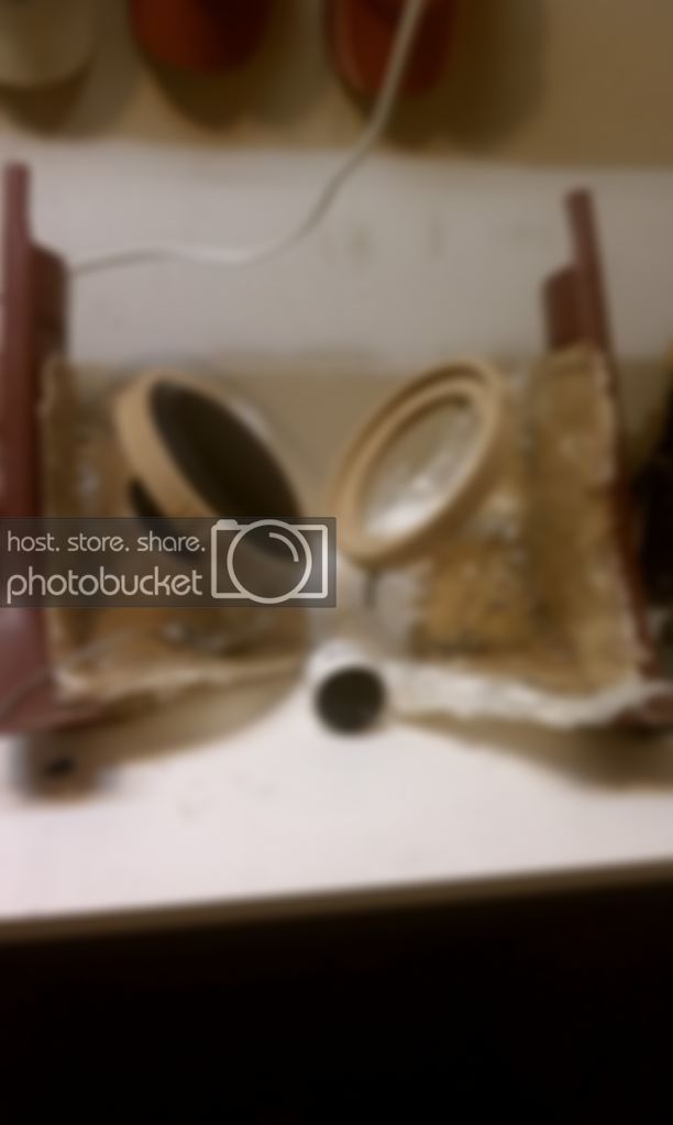

I finally got some pipe strap or whatever it is called to help with the angling of the speakers. I saw this done before and so far it works well. I will be using a laser to alighn the mids with the opposite headrest. I will also have the tweeters up in the sail panels even though cdt audio says not to. If somone can give me a reason not ide like that because I want them there to raise the sound stage a bit or is it possible to do that from the mids location. The tweeters will be aimed the same way as the mids or does somone have other suggestions Im trying to get this to sound the best as possble
also note the tweeters are in 1.5" pvc end caps. the fit is pretty snug with one layer of electrical tape around the tweeter. I will use this in the kick or sail panel depending on what happens so it has a pod that can accept other tweeters.

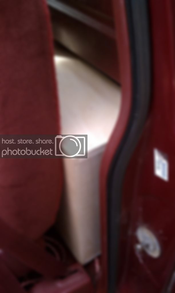

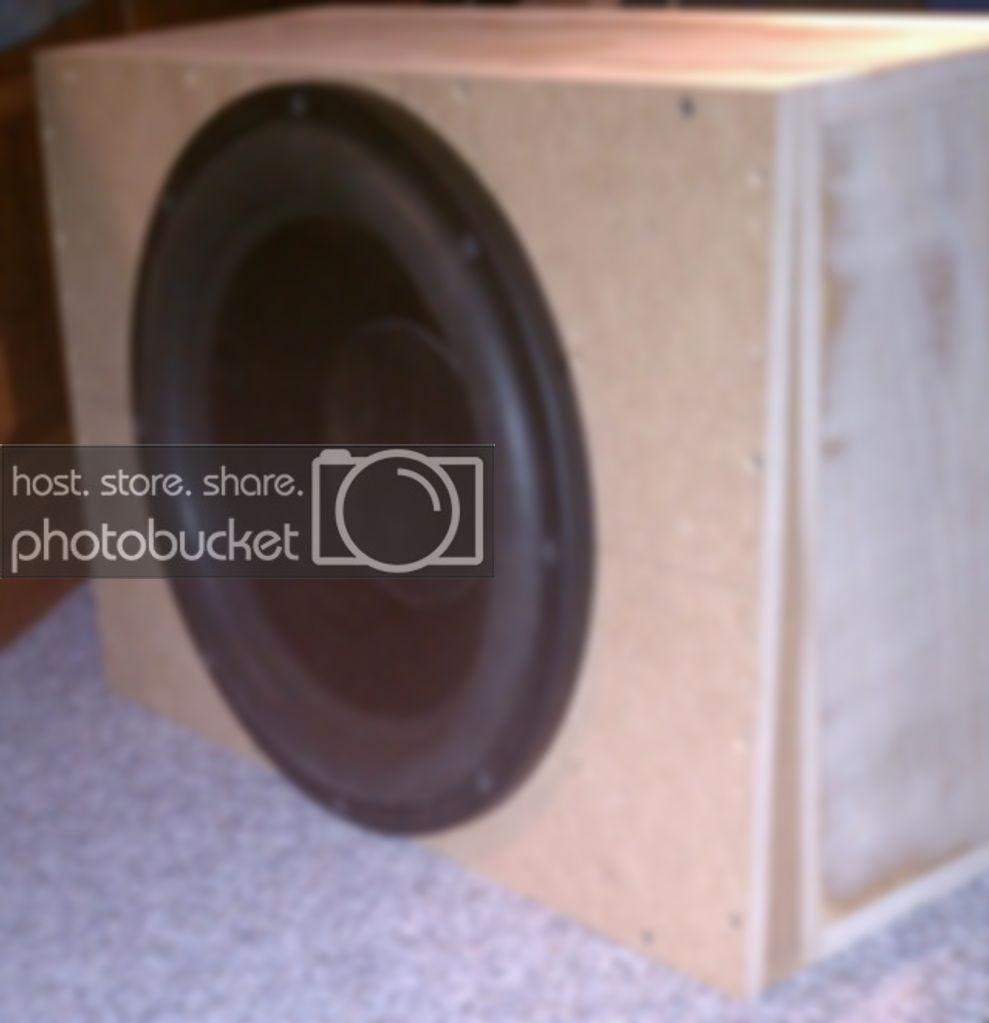

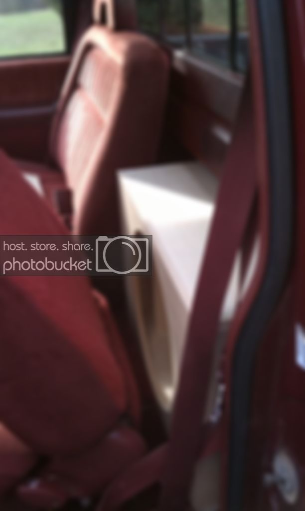

Made a mock up box for testing with scrap it was to shallow so I'm going to add a another layer of 3/4 ply to the front. The final box will be longer and slanted slightly. The bar grill I'm going to buy will keep the sub off the seat. I hope having it really close doesn't affect the sound to much. The volume for this test box is rather small only 1.25 cubic feet I am aiming for 2.2 which I heard gives an alignment of .707. Right now it is probably like .9 not sure.
Now I am starting to think, that the box being back there with the extra 3/4" mdf and on top of that a bar grill that has 1-7/8" clearance, there will be a huge reduction in sound quality due to the seat being in the way but the grill will keep the space around the subwoofer completey open. I can move the seat from 3 clicks back to only 2, as I am a small guy, and this will make the seat barely touch the gill. The new box will be angled in the front, and the subwoofer will be angled with the seat. Also note that as you can see there is about 3/4" of the sub being open to under the seat. When i get a chance I will do a test size of the totalt depth with wood and see hot right it is against the grill.

-Added a thinner box for more airspace 5" deep x 30" long x 16" high
-Angled the front of the box on sub side only
-Box volume after bracing displacement and without sub disp is 2.39 cubic feet
-Qtc of .711 will rise to like .73 to .75 at most with sub displacement
-Not sure what the avalanche's displacement is if anyone knows let me know I cant find it anywhere

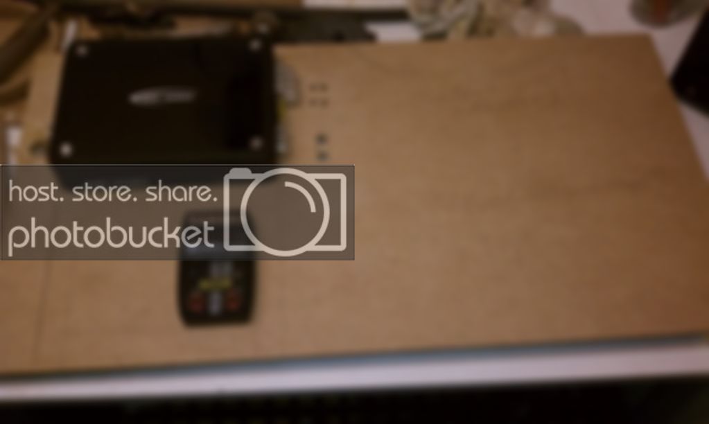

-Built an amp rack

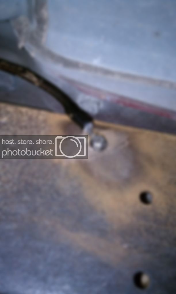

-added an amplifier ground to the frame instead of the sheet metal
-Had a ground loop fixed, that by grounding the headunit to the frame
