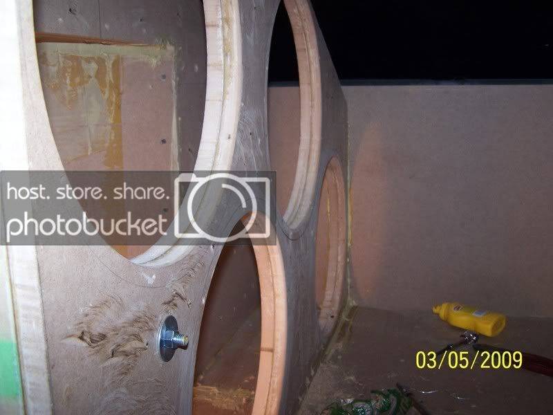

How do you use all-thread as bracing? Just make the hole slightly smaller (it's 3/8") and then thread it though with nuts and washers on the inside and outside?
Get me a quick response and I might even make a build log by the end of the week //content.invisioncic.com/y282845/emoticons/biggrin.gif.d71a5d36fcbab170f2364c9f2e3946cb.gif
correct, drill the hole large enough for the allthread to barely fit through, run a washer and nut up on the inside and outside, seal it with some silicone and you are good to go. Might use some loctite
for a cleaner look use a carriage bolt on the visible side and join with a coupling. you can even set in in and fill over and wont even see it after paint/carpet. to use 2 carriage bolts you need a reverse thread one and a turnbuckle with jam nuts.
Didn't know if you literally threaded it through or something of the like.

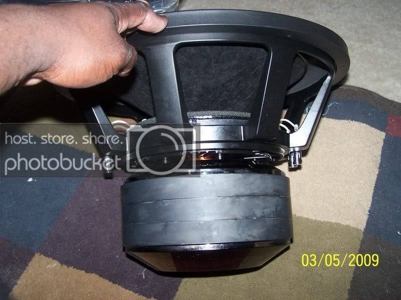

DP's inverted anyone? //content.invisioncic.com/y282845/emoticons/veryhappy.gif.fec4fed33b4a1279cf10bdd45a039dae.gif:veryhapp:
you tell me?
they sure will be inverted in here...
