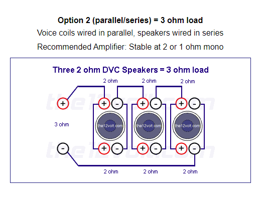

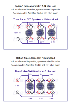

You have 3 dual 2ohm subs and the amp is not 1 ohm stable which means the you have 1 wiring options as follows:
That should give you about 2500 watts for three subs that can handle 6000. I would advise exchanging both and starting over. The subs are competition LOUD overkill that you'll never utilize the potential of, so, maybe exchange them for something that can handle 1000-1500 watts apiece, x3, still a LOT of power.
- OR -

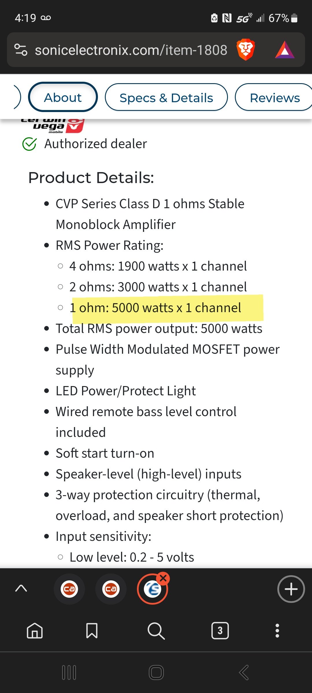

If you're set on keeping the three subs, return that amp ($399 ?) and get something get an amp that is 1 ohm stable like this ($319):
It's a real 5K amp.

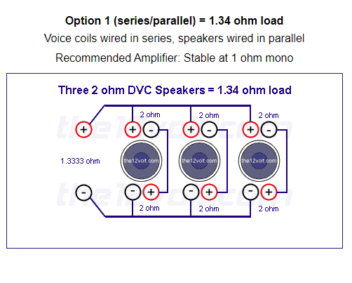

You can them wire the 3 subs like this:
And with it wired to 1.3ohms, that amp will push 4500+ watts to the three sundowns, might blow your windows out too, but hey, that's what insurance is for, right?

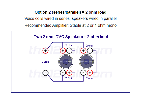

Good to know. Running 2 of them you will want to wire them as follows:
That will give you a 2 ohm load and allow to utilize the 3300 watt amplifier. Sundown recomends a 2.5cubic ft box, tuned to 32 hz.
