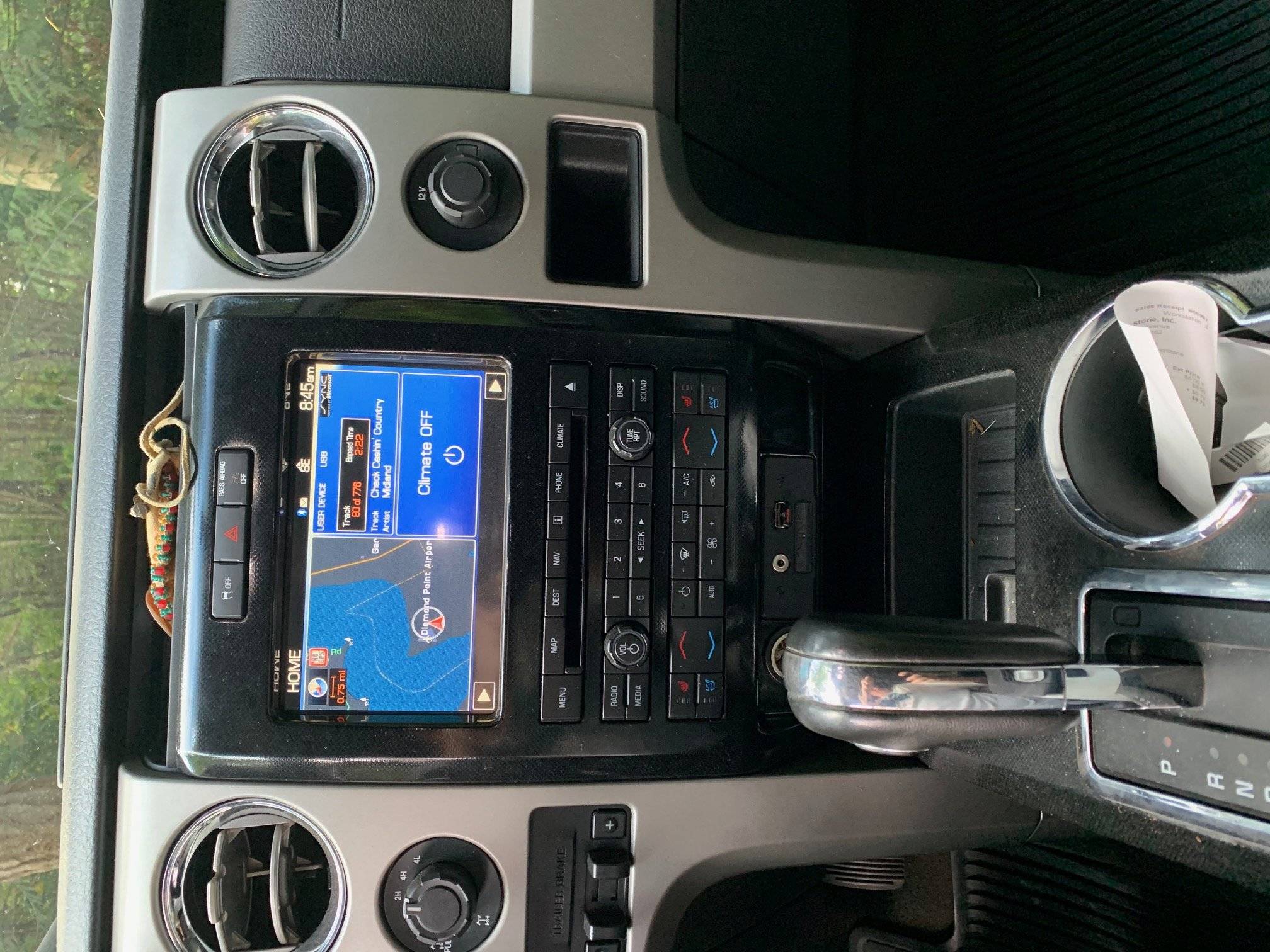

I'm having it installed by a shop on 9/10. They are making brackets and trimming the dash. I'll post pic when done if you like. The Kenwood has climate controls and am told the Maestro will retain all of the buttons below the head unit. I've attached a before pic.

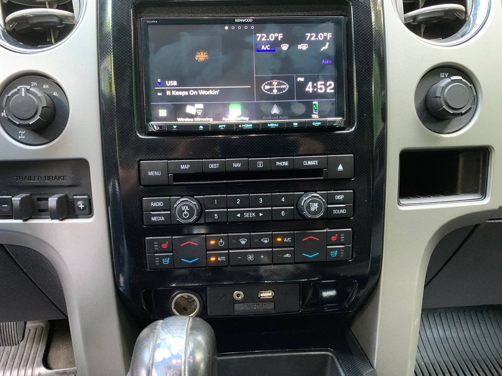

Install completed and seems to be most everything is working as stock. The menu button below the player no longer functions but the menu button on the receiver works. All he had to do was trim a little of the backside of the center section of the dash and he made 2 brackets. He tried to center it but there was too much wiring above so it sits a little below center. He also trimmed the Kenwood trim piece. I'm still using the stock amps and speakers for now. Phase one completed.
