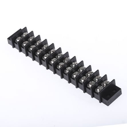

I'm using terminal blocks like this in 2 locations in the output speaker signal chain:
, as well as wire taps like this in 2 locations :
22-18AWG-Female-TTap-Male-Insulated-Connector-Wire-Terminals-Quick-splice-Disconnect-Combo-Tips10-25-50pcsMale.jpg
is it possible these are decreasing sound quality at a significant level? I could replace them with wire nuts or solder, but would that make the world of difference?

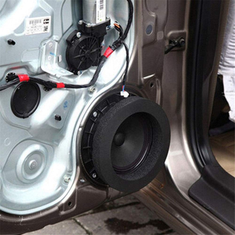

Fully deadened with actual Dynamat, both the exterior panel and the frame. And yep, foam baffles to prevent damage.
use the stock foam surround that is used in front of the speaker cone when you remove the door trim.
I don't exactly know what you mean by this. Like this?
What level of output are you expecting out of these 6.5 inch drivers? I suggest you post a picture of the doors with the drivers installed to gather honest advice on where you're lacking
For the most part you're correct in wanting to use an EQ to adjust harsh distortion, but there's usually other factors to consider such as overlap and which filter slope you're using
Yes, that's right, usually the stock speakers only have a 1/4 inch thin foam, the one in the picture is a good one!
