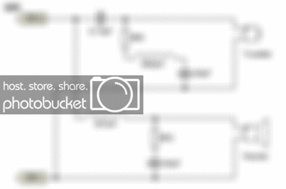

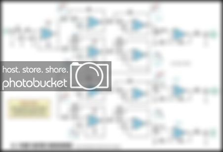

Can you show me a rough diagram of what you mean when it comes to active and passive cross overs? I just can't get the concept of it. Sorry for being so dumb lol
here is a basic active crossover

OP here is a sticky about passive vs active http://www.caraudio.com/forum/showthread.php?t=146726
Active is setting your crossover points before your amps and running 1 amp per speaker or speaker pair or a 4 channle to mids and tweets ect. Passive is running crossovers on the speaker outs after the amp and connecting mid and tweet to the same channle. More indepth explanation is in that thread
