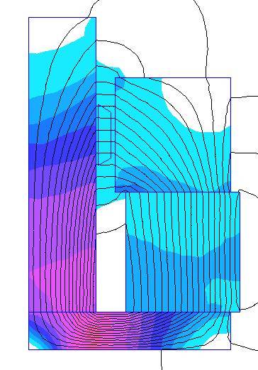

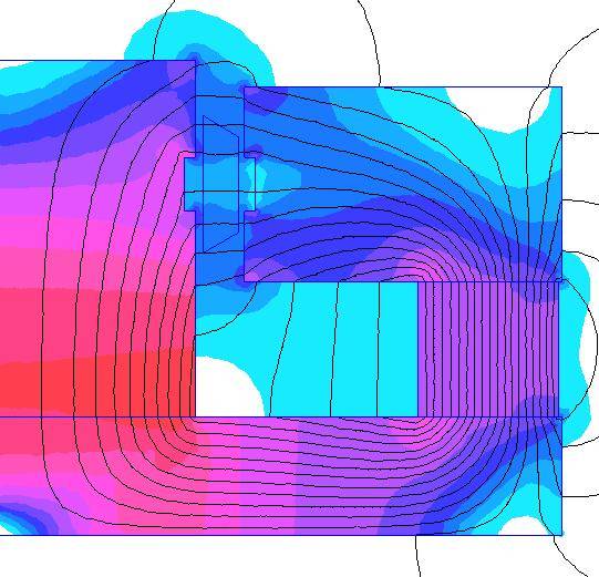

Ok. I understood the reason behind underhung, guess I just never seen a flux diagram with an underhung motor. So, with the shorter coil, the entire coil should stay within the main motor force area (don't know what that's called //content.invisioncic.com/y282845/emoticons/crap.gif.7f4dd41e3e9b23fbd170a1ee6f65cecc.gif) throughout the full stroke? As opposed to a longer coil that would have part of the coil inside, part of the coil outside on each side of it's stroke. What are the differences there?
In underhung the coil stays within the gap through the whole stroke. Original RE XXX was underhung and AFAIK MT was as well. More often used in midrange. You save mass for sure and get a very even BL curve until the coil leaves the gap. As OP stated, they're great until you get into big excursions. Big downside from manufacturing standpoint is you need a big arse top plate.
