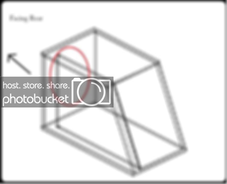

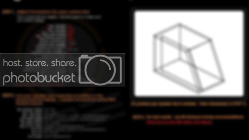

Hi guys
I used RE Audio to design this box and was wondering if its okay to mount the driver on the opposite side of the Ported slot.
I am doing this because I wanted the port going through my ski pass due to the design of my car. Thanks!
is it wedged to fit tight against the back of a seat? The port needs a
'buffer zone" for air flow
I see you wanna get the port to play through the ski port, but is it ALWAYS open?
Also not enough port area
if i was paid a quarter everytime i heard or seen this comment man i would so paid right now.
okay no that won't work to answer your question, i don't think it would, you would have a better chance of doing a "skip box", thats what i call it cause the guy who designed it goes by the name skip01 on this very forum.
sub on the side of box an port in middle, mind you now he used aero ports in the middle i am think slot port would need some fine tuning.
Am i wrong?
