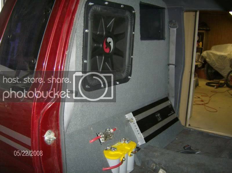

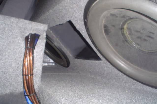

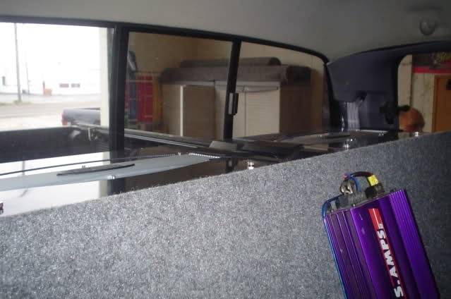

subs/port firing toward the floor. heres one of the vehicles i ran last year. 99 club cab dakota.
thats pretty impressive thanx for that I'll have to try that for a non wall application
how did it preform?
i was more than happy with it.
99 dakota club cab lifted on 35's daily built for 42's to play
2 - TC9 based 15's quad 1's in 8ft3 120sq" @ 38hz
2 - Cadence ZRS10's stapped @ 2ohms
US Amps US 50 for the front doors
Stinger SP1700 under the hood
2 - Kinetik KHC2000's center console
yes the subs are ugly but they got loud
149.3 @ 44hz at the kick
