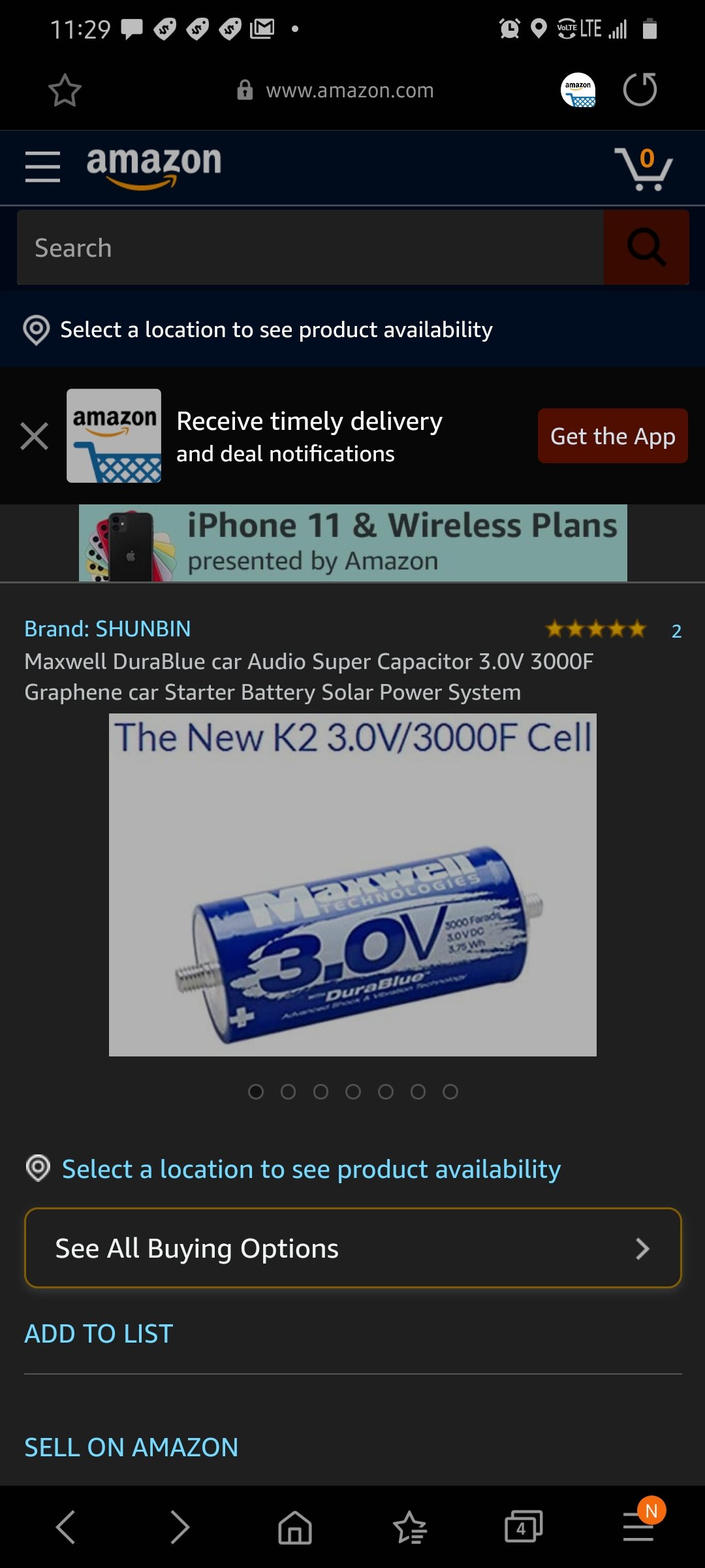

Would this be the correct one?

Yes, but you need banks of 6 to do any good and adequate alternators to keep them charged. Capacitors are not going to help you support 1,600A of current draw.

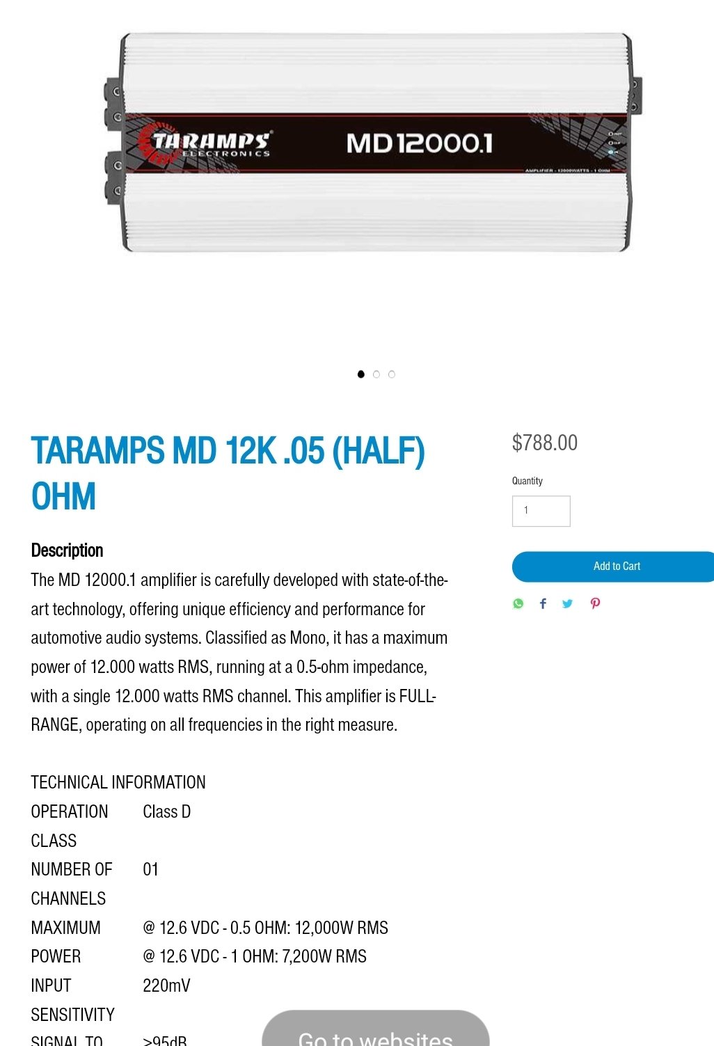

What would be the outcome if I were to run two 8k's on my current electrical?

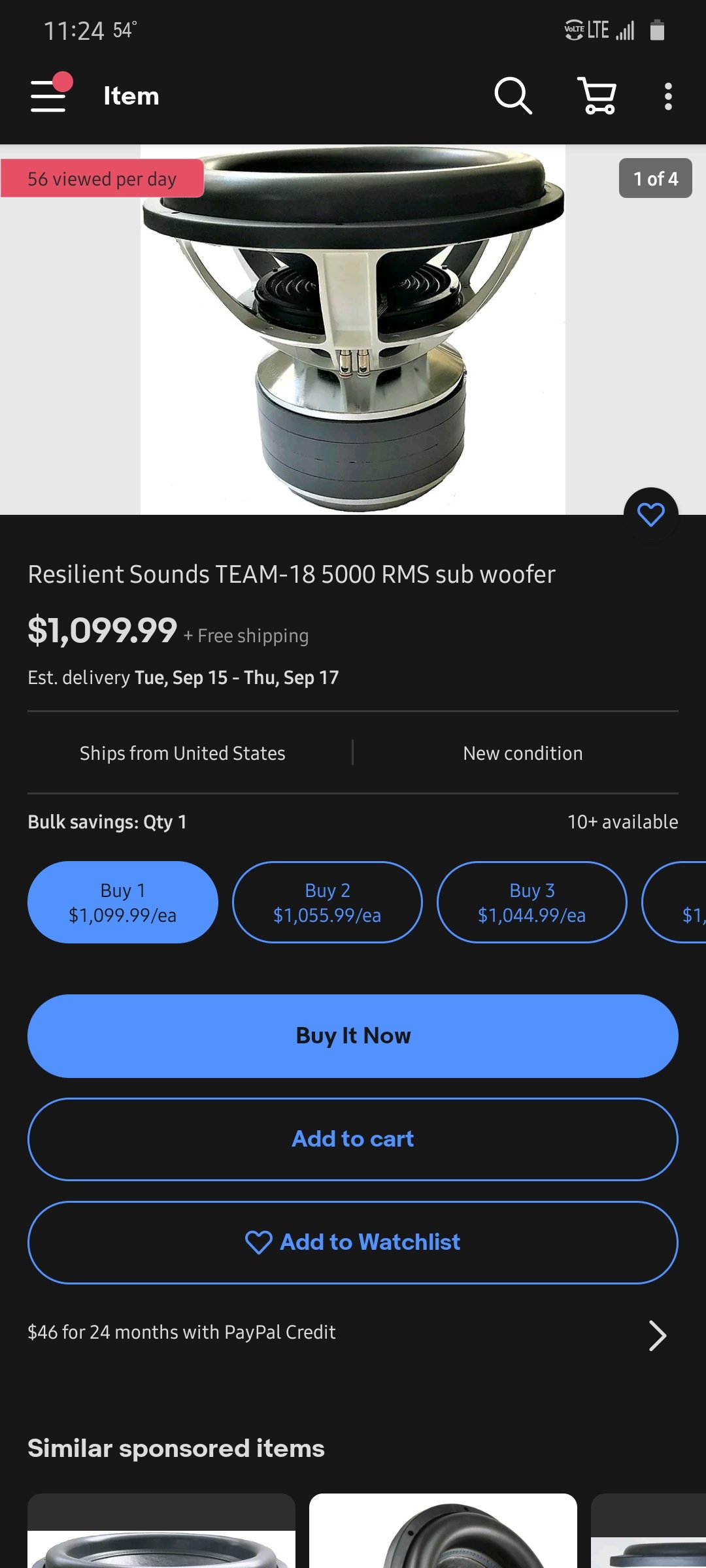

See i was thinking about going with a single 18, like a team sub, and hopefully be able to feed it roughly 5k.....I understand it's all about testing but do you think it would be possible?
I was also curious.....is it easier to get louder with multiple subs on low watts because of cone area or easier to get louder with more watts with a better sub......example......my two 9500's on 5k or a team 18 sub on 5k.....because the team sub has a bigger motor

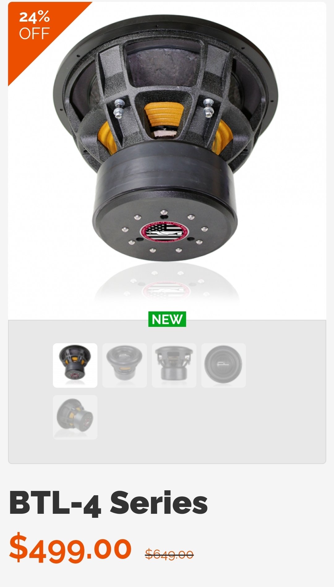

Nevermind scratch that......I was looking at the fi btl 4 12"......two of those..I lied.....im really liking the fi sp4v2 12"......i think im dead set on those.....sound like a good choice? And depending on which car I get I can buy another alternator also

And just ONE of those Taramps 8k will want to draw as much as 800A Where's the other 650A coming from? If you use two, where's the other 1350A coming from?
They won't make near rated power and they may sag voltage so bad they'll power off, power other accessories off, or blow themselves up.
Fi products are good across the board. BTL may be about comparable to 95xx with the new larger coils. SP4 are solid and take a ton of power, but they take a ton of power to get loud.
You can get loud with power and/or cone area and each is its own set of challenges. Power is cheap these days as far as amps but battery can get spendy. Lots of woofers obviously is cost of subs, weight, and bigger (heavier) box.

So the btls are comparable to the 9500....so the sp4 would be a noticeable upgrade from the btl4?
The only thing "upgraded" about SP4 is you can throw more power at it. It willnot be as efficient as the BTL or 95XX

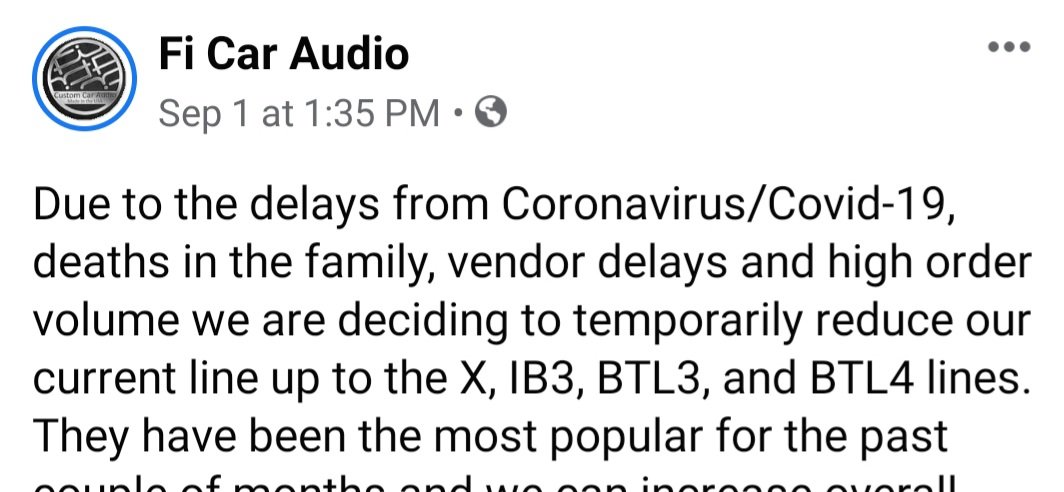

Unfortunately Fi has currently halted production on the sp series until further notice as I was getting ready to pull the trigger on 2 sp4 plus 15s.
