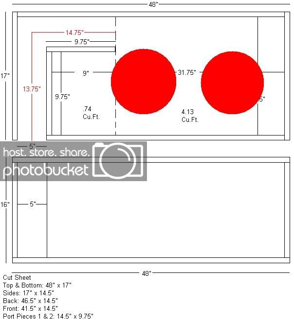

so i just cut two holes on the top? anywhere special on the top? and will it matter that the port is on one side and not in the middle?
it doesn't matter if the port is in the middle. just build the box and cut the sub holes on the top, instead of the front. just don't cut in to the port wall.
so like this?
the red circles would be the sub holes (not in scale or anything)

if you want. might as well just paint the whole inside with cheap paint.
if they are dual 4 ohm, you'd get a final 1 ohm load. a few more watts would be nice for those. the hifonics bxi1608d, would push them better. R's can soak up quite a bit of power.
