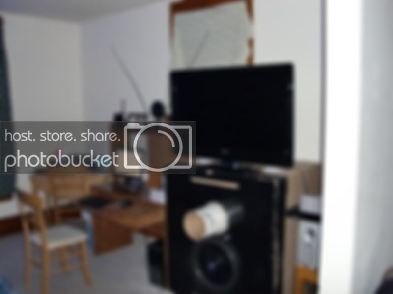

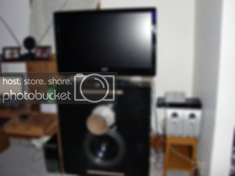

Finances are here. Time to start ordering. PICS and VIDS to come! What is for sure: 2 Fi Audio IB3 18's, each in their own 128 cubic foot box (before displacement) with a 12" sonotube port 48" long ( to begin with, will cut down raising tuning over time) resulting in a 6.5Hz tune! Dual EP2500's or EP4000's.
I am building from the floor up... scratch. I need a solid 7.1 receiver capable of more than 110 watts per channel. I plan on building MT's or MMT's designed by Kevin with Exodus Anarchy's. IDK about using a HP filter yet.. but I may go as high as 15Hz with the tune...I'll start low and have myself some fun and learn all the way up to 15Hz.

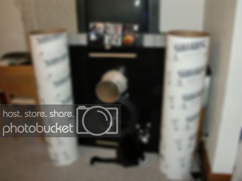

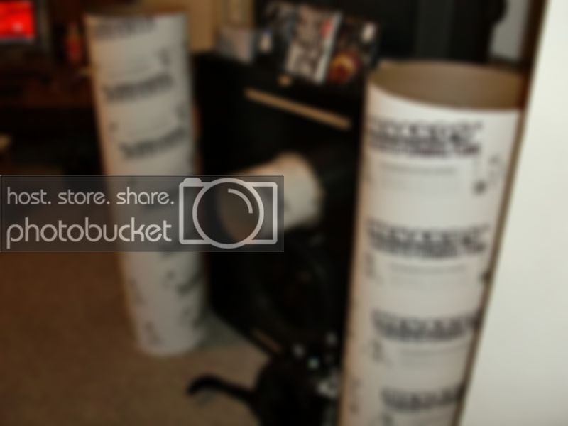

Got the VAN. Got the CAM. Got Star Trek, Transformers, and G.I. JOE. Got 2 12" ports. Who has 12" sonotube ports? I do NOT bring the cat into this. EVER! He does it all on his own! I think he's good for scaling anyway.

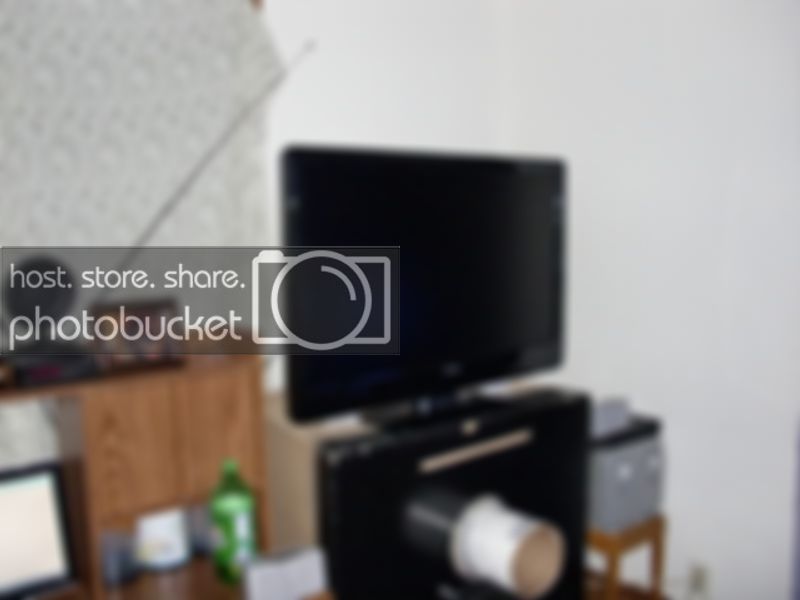

We've already established that my home is hood. My setup is ghetto. please don't make fun of my imported curtains from spain, that's not nice and I don't want to have to rub it in your face how much I was able to get them for! I'll be painting soon, getting shades soon...but who cares it's all about the sub. WARNING car audio guys. These are boring vids. They are ONLY to demonstrate and document how these low BL, under motored "IB" subs have so much efficiency when given airspce. This is also to show that I do get a little port turbulence. This is only around 100 watts. It shakes my house and everything in it. On the opposite side of my home my windows rattle and the home completely breathes in and out with every woofer stroke. We will see what happens with a pair of EP4000's later on.
