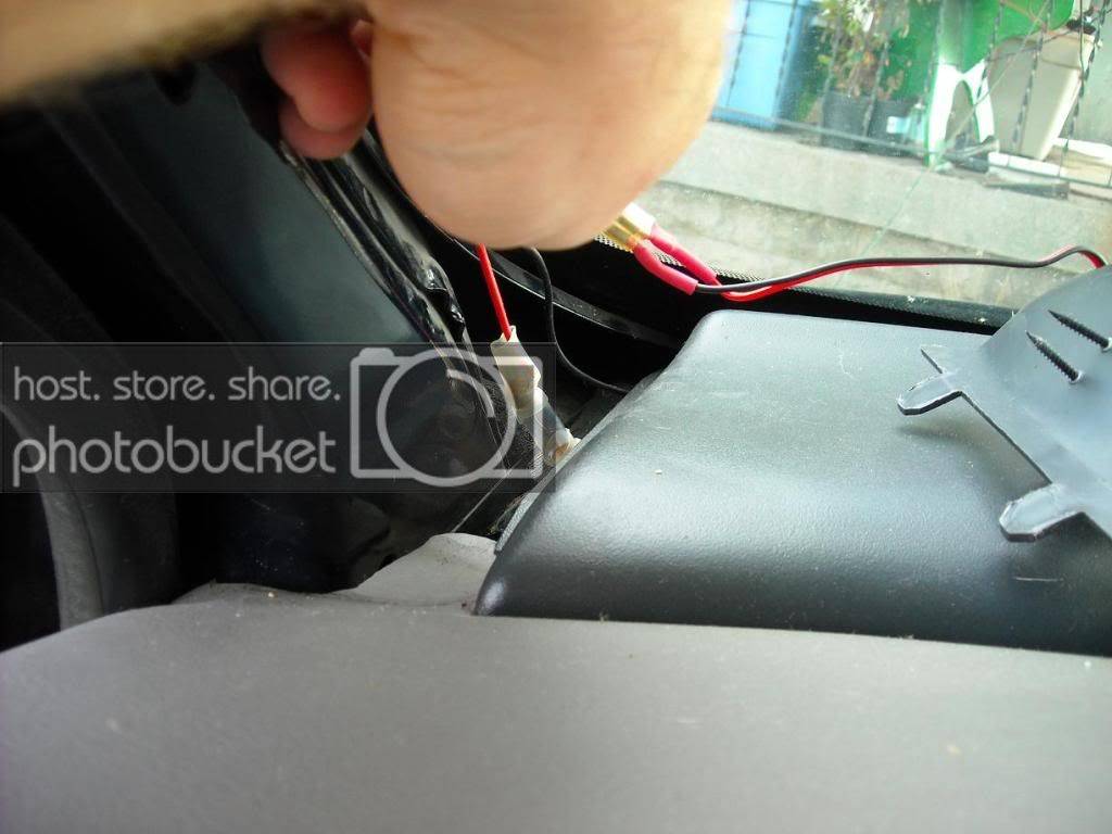

Showing the bulb pulled up from under the dash a little.
Picture of the blown bulb pulled out of the bottom of the dash.
Pic of the old bulb ready to be unsoldered.

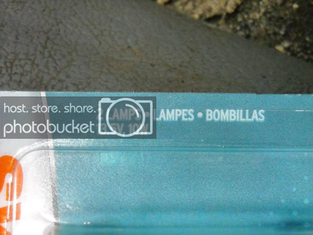

Pic of the packaged for the new bulbs, not exactly the same as the old ones, but just about any bulb like this will do.
Pic of the specs on the new bulbs, same specs as the old ones. I'm putting a rated (not measured) 150watts RMS to each component set and the old ones have held up for about 2 years now, didn't see a reason to change anything.

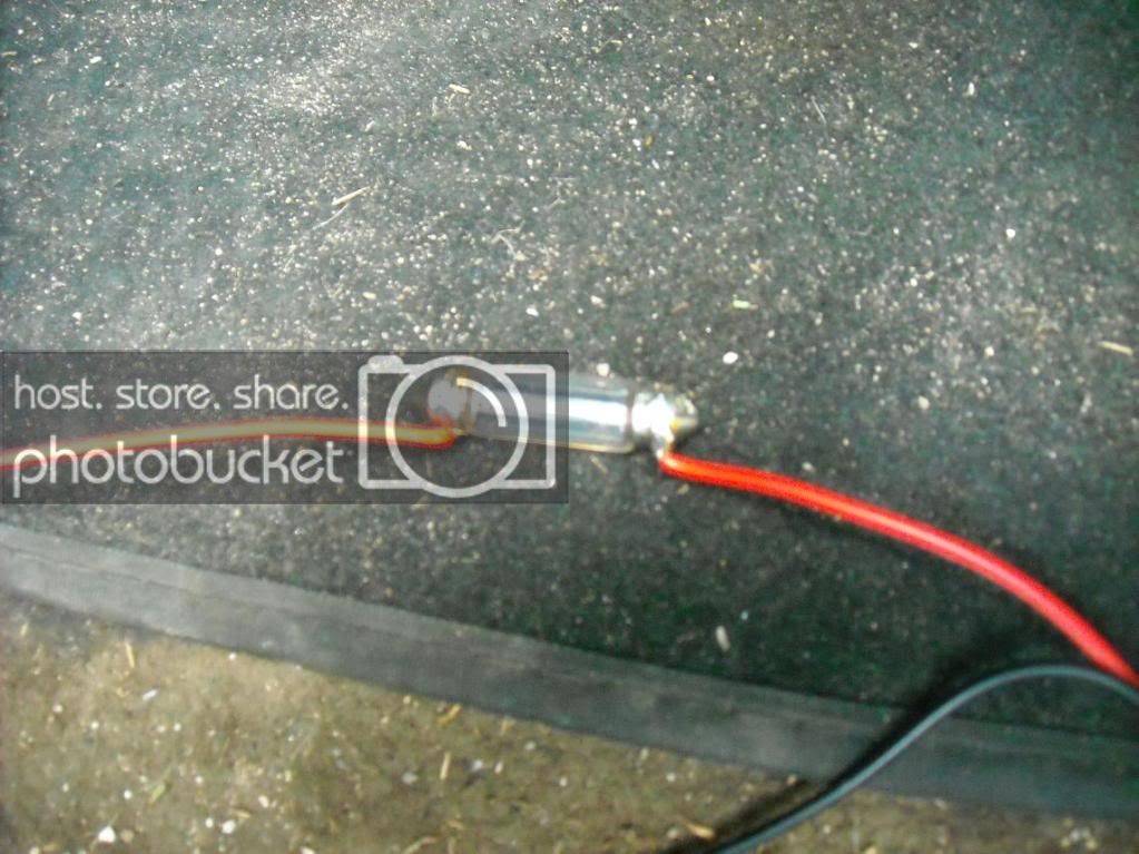

New bulb soldered in.

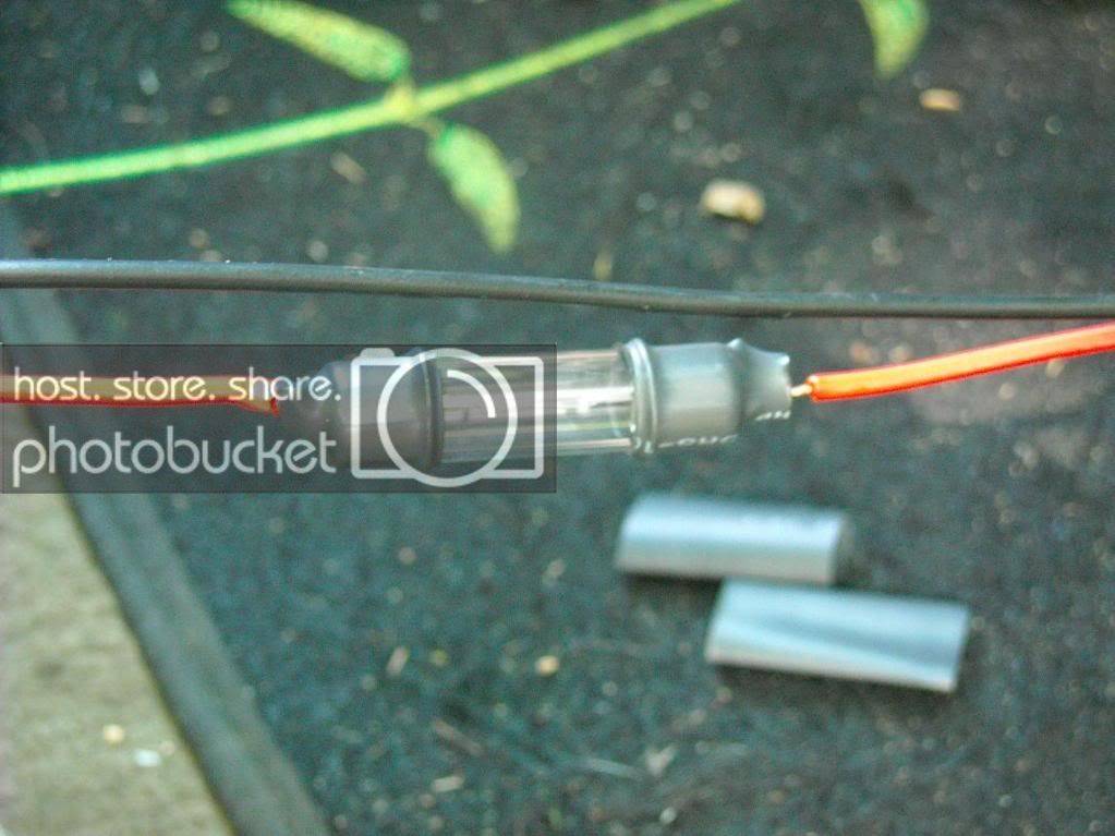

Heatshrink put on, cleanest way to keep the ends from shorting on anything.

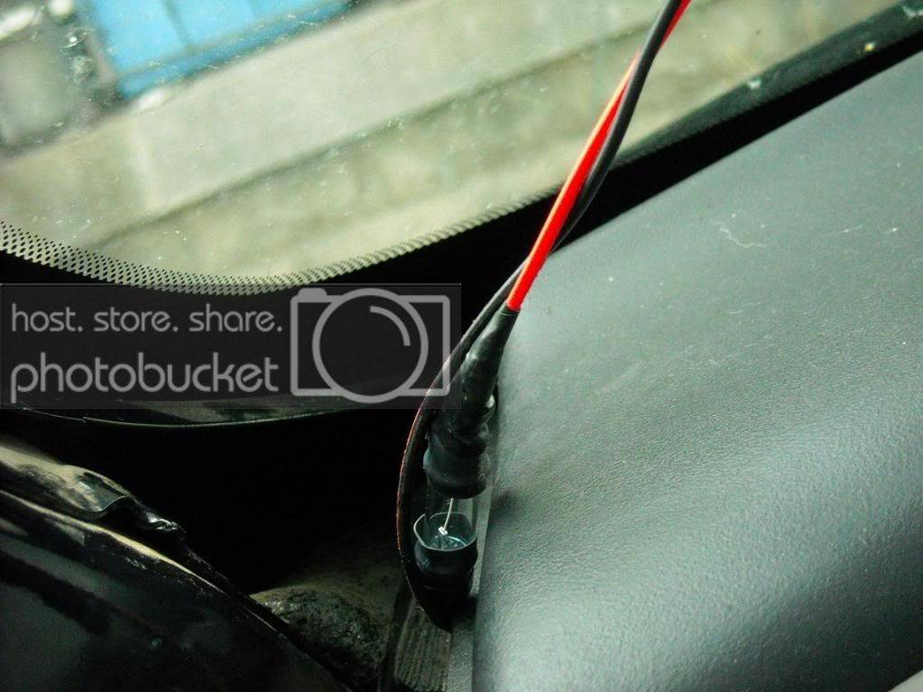

I also added some electrical tape to the ends to help support the wires since they're such a small guage. When I first installed these I had problems on the back door with the wires breaking off from the bulbs.
