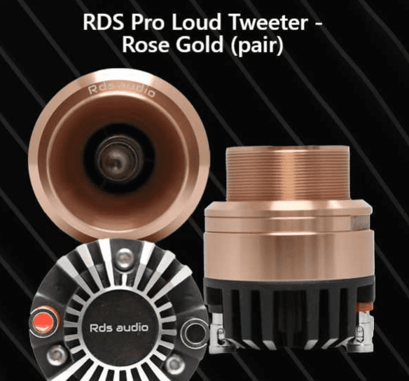

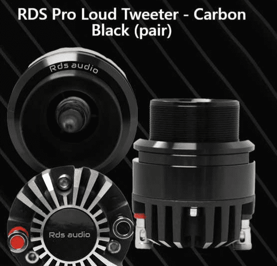

I'm no fan of tweeters (not tweaters) like that but I have a local friend that sells some very obnoxious ones.
Check out RDS Audio

thanks for the suggestion all though these tweeters max at 105db and 100w rms im looking for something more power and id like to be able to buy it in eu too this looks like a us sight allthough for the right tweeter id still buy from there
