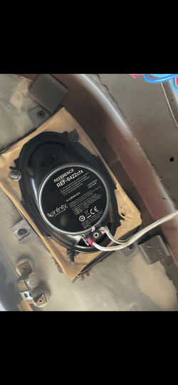

The front speakers are definitely are not power house units. 45w rms. I attached a photo. The kickplate speakers are a little bigger, but still not very strong. I plan to power them from an independent amp eventually, but right now they are powered off of a factory head unit, which doesn’t help.
There isn’t a ton of room in these cars for deep aftermarket stuff - especially the kickplate speakers. It’s designed for 4x6’s.
I may go down the road of completely redesigning the speaker mounts eventually, but for now, the speakers there are decent SQ so I decided to put my money into the rear box.
Evolving the front speakers will have to wait for another day $$.
