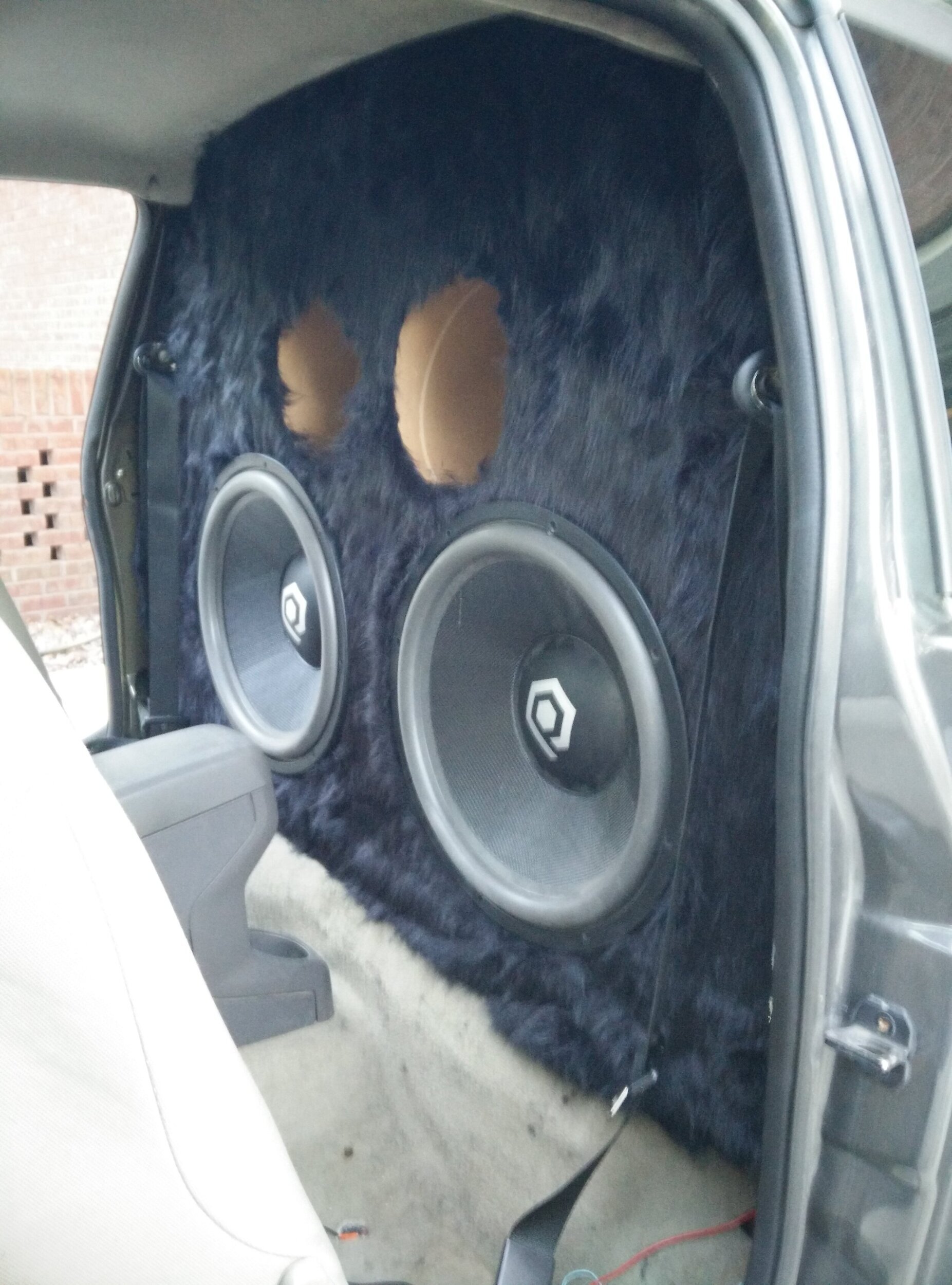

Found an old picture of my two 10" sono tube ports.
Goddang dude that must pound like a *****. I just ordered mine- It's only a single 10". It ***** I couldn't find an 11"- only even numbers.

I remember my 12" being 11.5" but don't remember what the 10"s were but they aren't exact size.

I know-they're 1/2 smaller. I've thought about buying a 12 just to see if I could stuff it in my box (port is a little on the small size)
