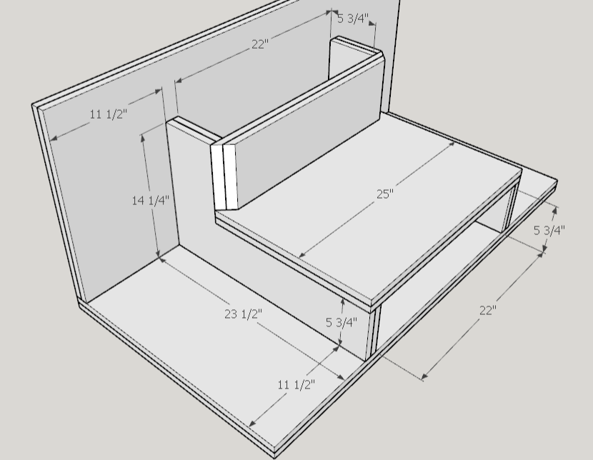

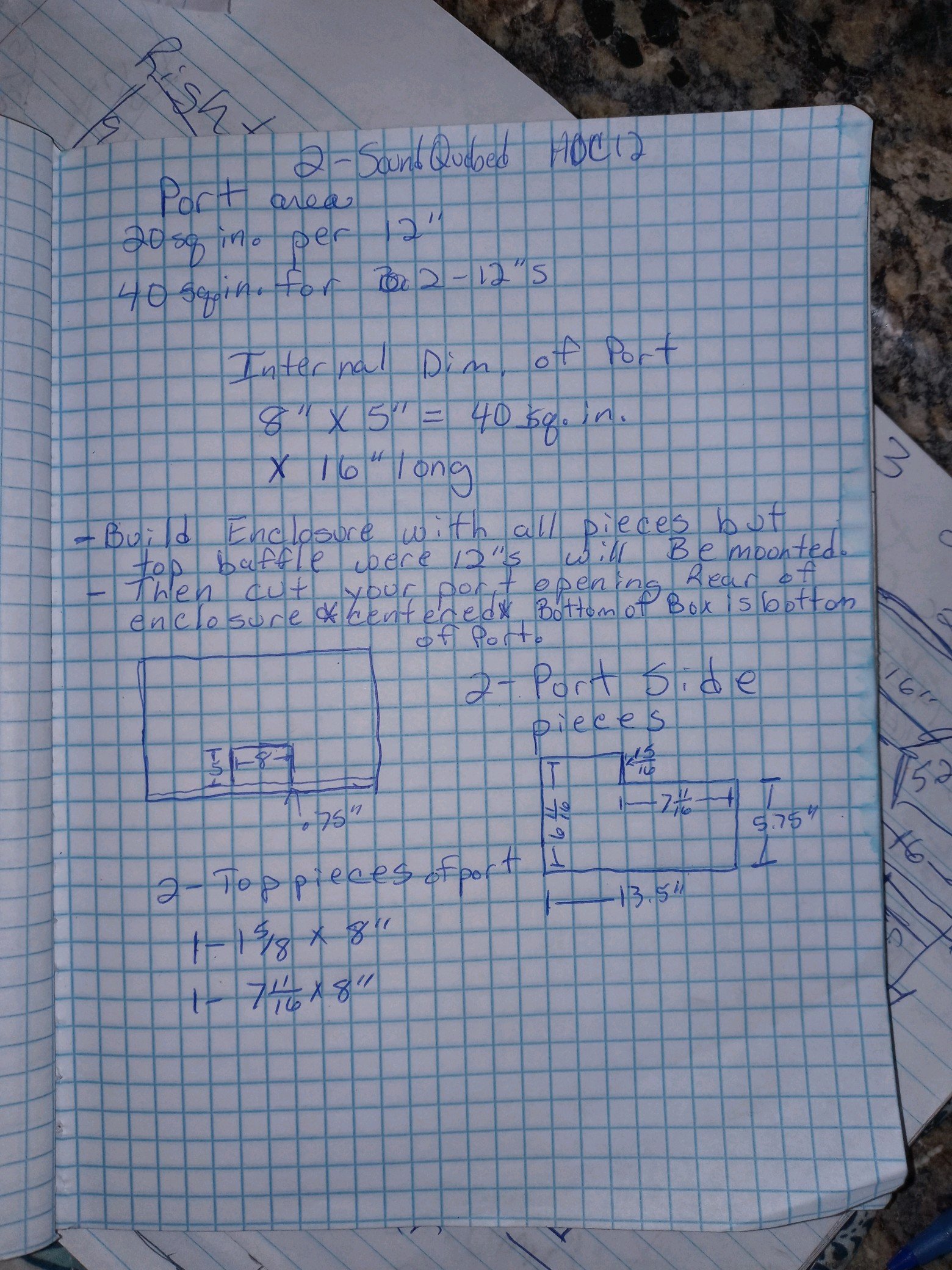

Hi,
I got a box design from someone and I'm stuck with assembling port. I have not seen this kind before and help would be appreciated. Already got everything cut just need suggestions
Thanks
