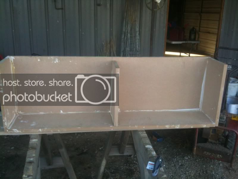

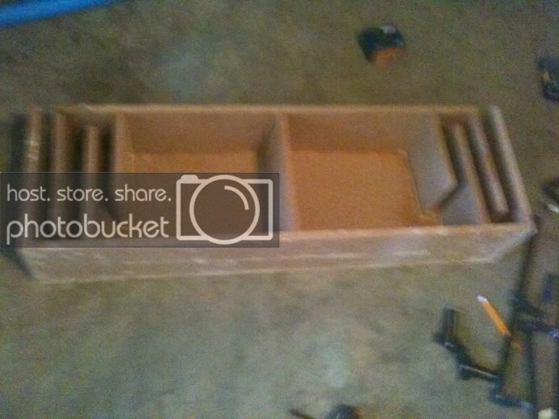

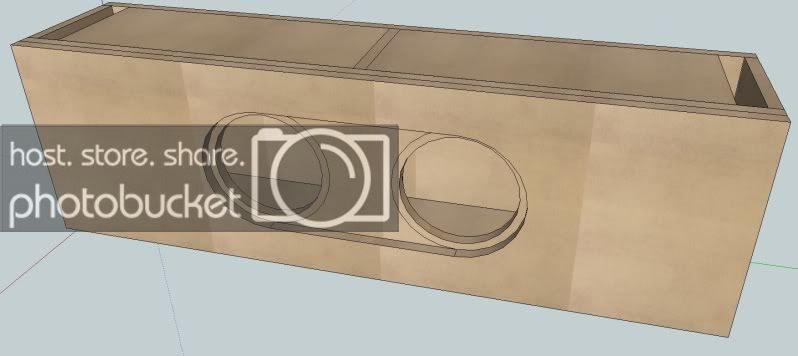

Box design for the 2 SA8s each chambered tuned to 32Hz

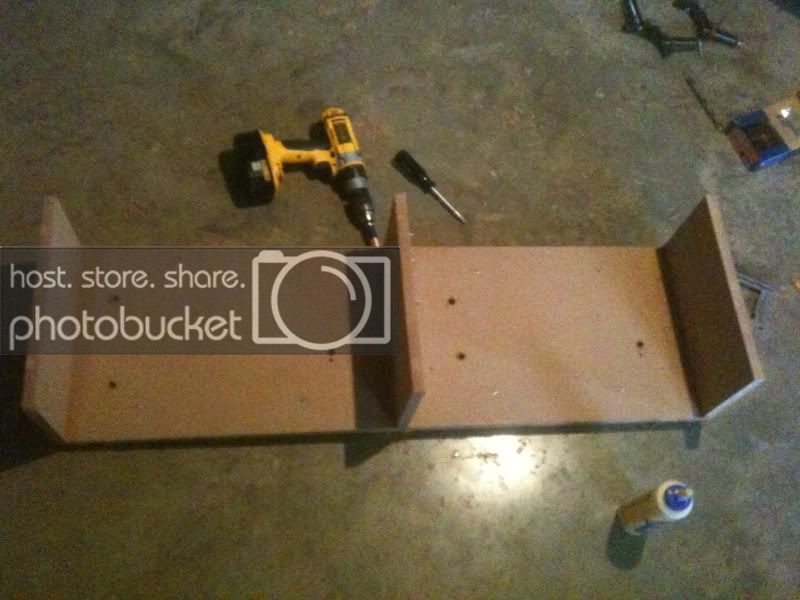

Amp Rack shelf to be mounted under the sub enclosure

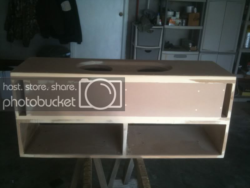

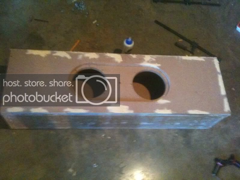

Wood filler going on all the edges to smooth everything up. Lots of sanding to be done still. This box will be painted Imperial Jade Mica to match the exterior of the truck.

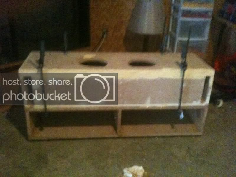

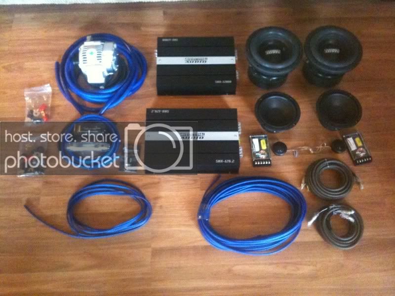

Got my mean green alt in today //content.invisioncic.com/y282845/emoticons/peace.gif.2db28b618ed8d1964ebbe2f5021d2c39.gif decided to unbox everything and take a picture of all my equipment. Did some more work on the box too still have a lot of filling and sanding to do to get it prepped for paint hopefully ill have it painted up by the end of the week.
it's mostly port, hence why it looks so big
Exactly and its dual chambered meaning each sub is separated with its own airspace and port. Its basically 2 boxes in one. The port is really long to get the tuning down to 32hz for some deep low end extension the overall dimensions are 45 1/4 X 14 X 19 with the amp rack shelf and everything it should fit nicely behind the seats in my extended cab taco!

i figured it out after i saw picture with all your gear. interested in seeing this build done since i myself am going to be running 8's on 1200w @ 1 ohm as soon as i finish my box lol. the only difference is my 8's are cadence sw2-8s with one of their amps. really want to put more power to them but will see how the 1200w sounds.

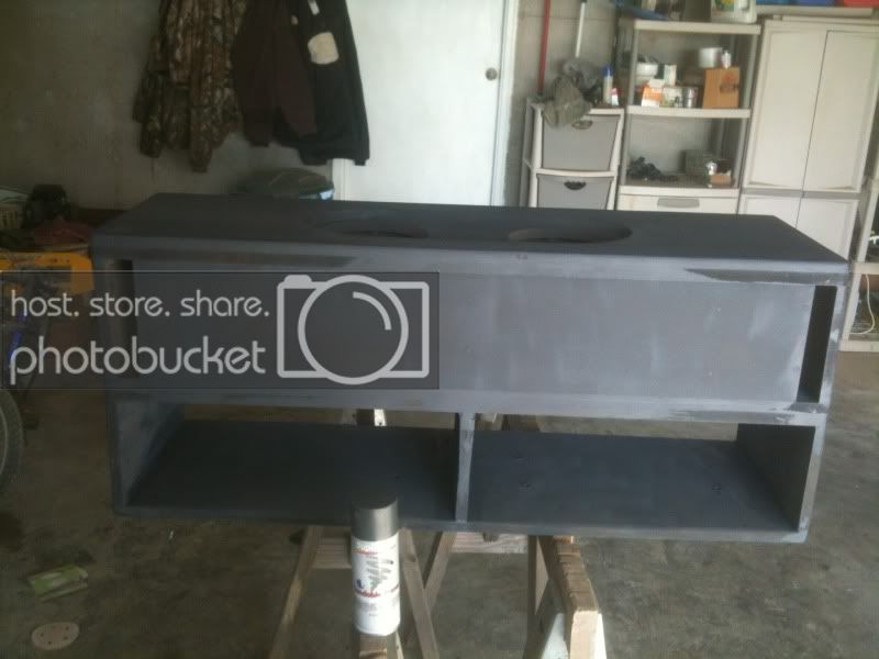

First coat of primer is done waiting for it to dry so i can start sanding and then do a second coat of primer followed by more sanding then some color coat //content.invisioncic.com/y282845/emoticons/biggrin.gif.d71a5d36fcbab170f2364c9f2e3946cb.gif followed by more and more sanding. I also ordered a Pioneer AVH-P4300DVD head unit along with the seperate iPhone cable so i can control my Pandora radio and Netflix apps from the head unit which is a very nice feature.
