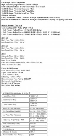

Have you considered Sundown? Their SALT 1700.5 has more than enough power for the entire system.
