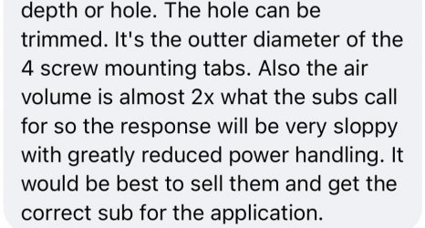

So I mis typed it… the enclosure is 3.5 and that’s from their website (see pic) I’ve also attached a pic of what the owner of fox acoustic said about it.
Run them and see if they meet your expectations or not. No one will know better than the listener to see if it meets the criteria or not .. Right?? What sounds good to me may sound like garbage to you. It may sound to your liking?
