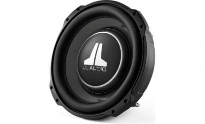

I have sourced an enclosure for my 2019 Ram 1500 crew cab. It’s a fox acoustics box. I also have 2 JL 12” TW3 shallow mount subs.
From what I read the suns require 1.3 cuft each in a vented box. The enclosure is vented and is 3.2cuft.
I’ve gotten different opinions about whether the subs will sound like crap because the enclosure is too big.
Thoughts ?

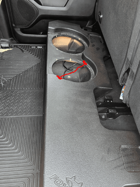

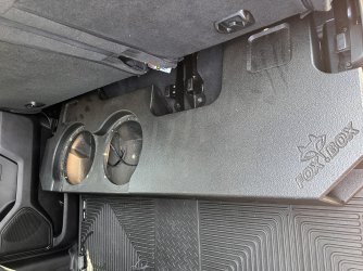

So I mis typed it… the enclosure is 3.5 and that’s from their website (see pic) I’ve also attached a pic of what the owner of fox acoustic said about it.

That's what you are buying? Take a sub with you, and make sure it will fit. Your subs have a larger required opening then what those came with, (you are going to have to trim that ring back). Plus it already has screw mount holes, and yours at the very best, 4 are going to line up, but I think yours might sit farther out.
The airspace will work, but that box might not. Take a sub with you, place it in both holes, and make sure it will fit. If it doesn't fit in the cutout, at least put it in upside down, and make sure it fits with that curve.
If this is something you are going to buy, it will be easier if you have them measure or ask the company what the face mounting diameter maximum is. If it's less than 13.2", your subs won't fit.

So I already had the subs and I bought the box because it was a great deal from someone I knew that was trading his truck in. I asked about the airspace in another forum and had no idea that Joe Fox (the owner of Fox acoustics) was in that group lol… I wanted to find out if the box was too big before I started modifying it so that the subs fit. It won’t be hard to make them work.
