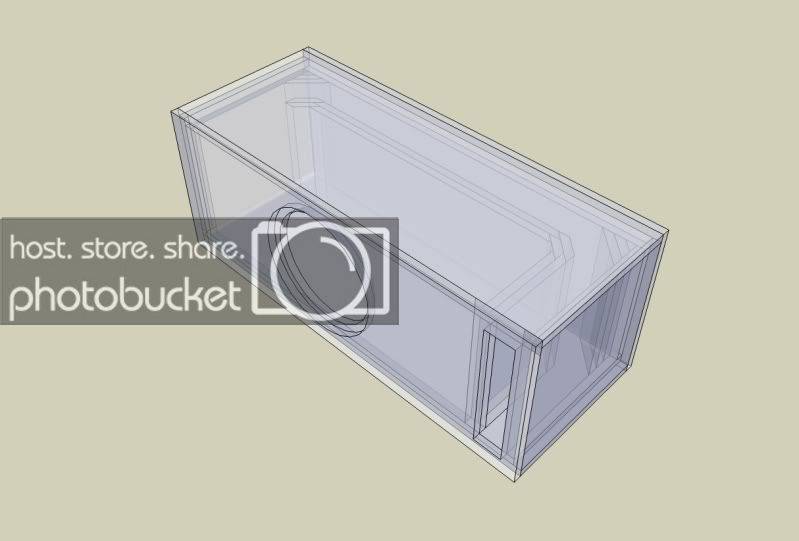

This was my entry
That's funny, same basic design as mine:)
I kept it simple, my actual build would have 45's in the corners and roundovers on the port of coarse //content.invisioncic.com/y282845/emoticons/smile.gif.1ebc41e1811405b213edfc4622c41e27.gif

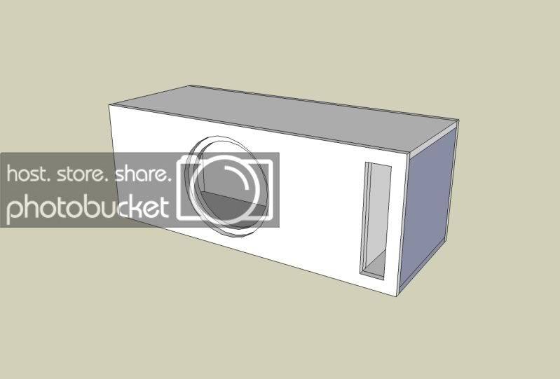

This was my entry
unless ive mistaken you forgot to double the top this is only suitable for for tnt, i dont see it withstanding these bold plastic explosive claims //content.invisioncic.com/y282845/emoticons/laugh.gif.48439b2acf2cfca21620f01e7f77d1e4.gif
edit: nvm i see it now //content.invisioncic.com/y282845/emoticons/crap.gif.7f4dd41e3e9b23fbd170a1ee6f65cecc.gif
lol no seriously nice job hanging with the bigger designers
o, well thanyou. haha, thought you were making fun of my lack of noticing the doubled top. yeah i love this stuff, trying to gather up all the proper tools to start doing the real thing. ive done a couple for friends but due to lack of tools, it takes longer than it should....
