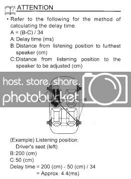

The RF DSP is weird... Has me measure the sub distance which is exactly 70" but I am to put in 0" for it's distance. What if I didn't have a sub... would I them measure the furthest speaker (Right Twt) and input 0" for that, measure the left twt and subtract its distance from the actual distance of the right twt? 54" - 36" = 18" for the left tweeter? Maybe I should get a different DSP lol.
Is your sub really 6 feet away from you? I find that hard to believe.
I just don't understand why they want the furthest speaker away to be at 0 distance. I followed these steps exactly:
i think they mean 0 because youre not going to delay your sub, which is your furthest speaker
kinda lame way to say it tho. idk
