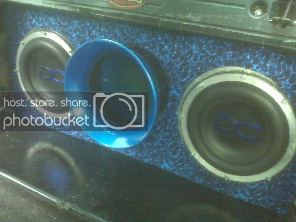

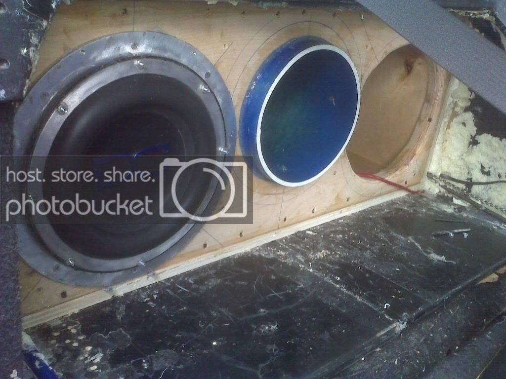

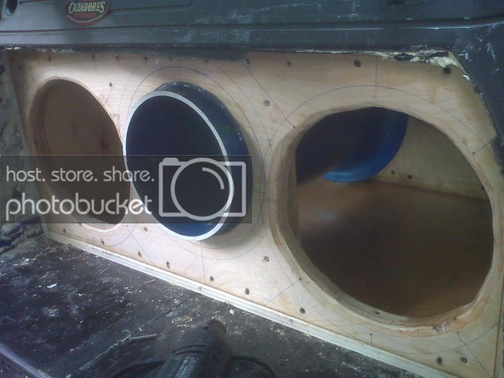

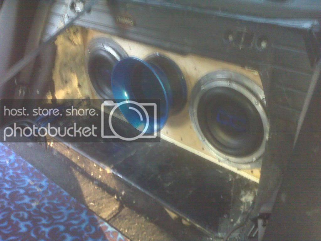

Holly crap. I can't believe you tried it. What you think so far? How big was the box? Looks like you could go to 12's if it's close to 5cf. And port is long as hell which explains the 32 hz peak lol. If you shortened the port you'll see big gains for spl but you'll of course tune higher.
lol I told ya I'd try it eventually.//content.invisioncic.com/y282845/emoticons/wink.gif.608e3ea05f1a9f98611af0861652f8fb.gif
After all displacement and adding to the inside of the back wall etc.. Its around 3.6cu. I'm gonna shorten the port and shrink the box by adding to the back wall.
So far I've been giving these guys hell running the AB at .35 daily and burping at 32hz //content.invisioncic.com/y282845/emoticons/crazy.gif.c13912c32de98515d3142759a824dae7.gif It is pretty cool to do hairtricks at shows and see the reactions as people look in and see a lil pr of 10's:suave:
