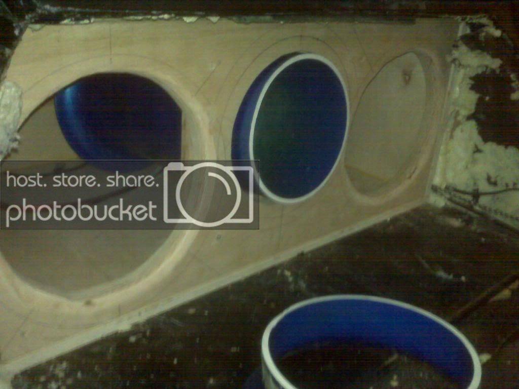

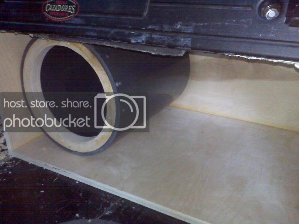

might have harder time sqeezing the two 6" rather then a single 8" At very min width with two 12's with a single 8" aero flare are about 39" but a little trick is if you mount the center tube of the 8" aero rather then the flare you save yourself about 3" of width. Like pic below. You may want to consider 10's with a single 8" aero. Box below does about a 152.5db peak at 45hz with about 4000w of power and about 151 with 2500w. Good luck.
Well my problem is the width I need for the 8 inch aero... Its roughly 12 inches in diameter and I cant squeeze that in a box that has a max of a 36in width... I am hoping to squeeze two 6's in the center but my box height will be a max of 16 in and I know thats cutting it close... Im just going to have to see I guess... If not I will switch to some level 5 10's...
You ever going to get around to making that box facing forward using a single 8-9" aeroport? //content.invisioncic.com/y282845/emoticons/smile.gif.1ebc41e1811405b213edfc4622c41e27.gif
The shell is made just waiting on my friend Jodie to hook me up with the 8in aero //content.invisioncic.com/y282845/emoticons/smile.gif.1ebc41e1811405b213edfc4622c41e27.gif

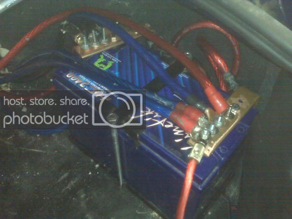

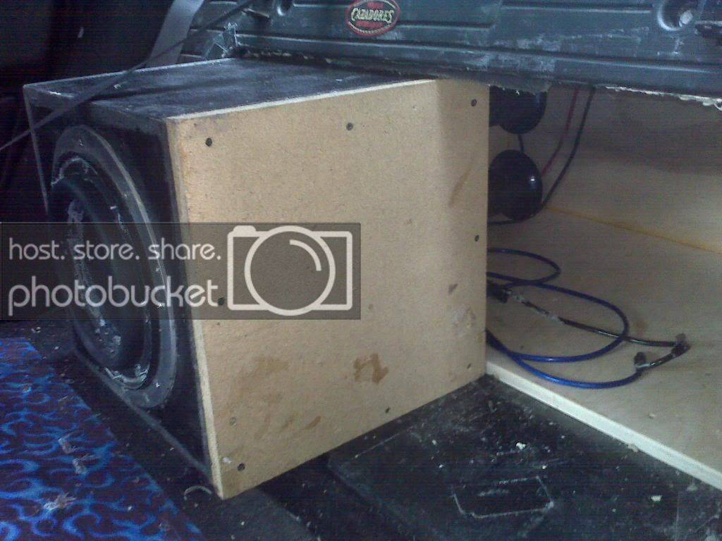

Heres what I've been up to today. Cleaned up the bars on one batt and made better connections and started to install next box and move everything to the trunk.

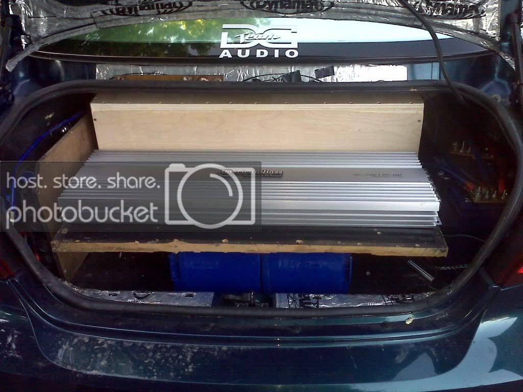

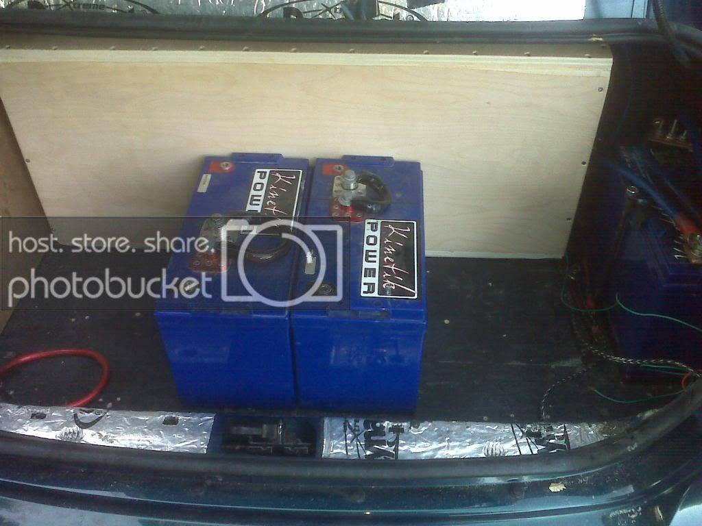

6 batts,3 amps,box and subs in Trunk.
