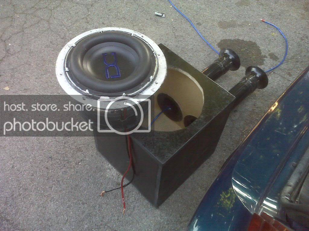

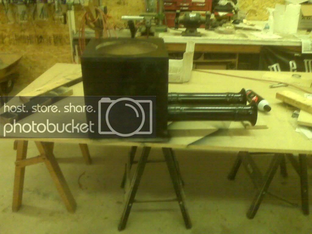

might have harder time sqeezing the two 6" rather then a single 8" At very min width with two 12's with a single 8" aero flare are about 39" but a little trick is if you mount the center tube of the 8" aero rather then the flare you save yourself about 3" of width. Like pic below. You may want to consider 10's with a single 8" aero. Box below does about a 152.5db peak at 45hz with about 4000w of power and about 151 with 2500w. Good luck.
