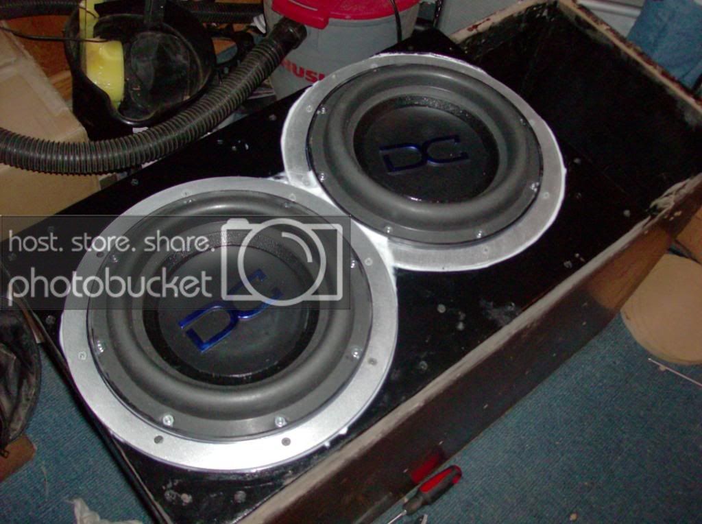

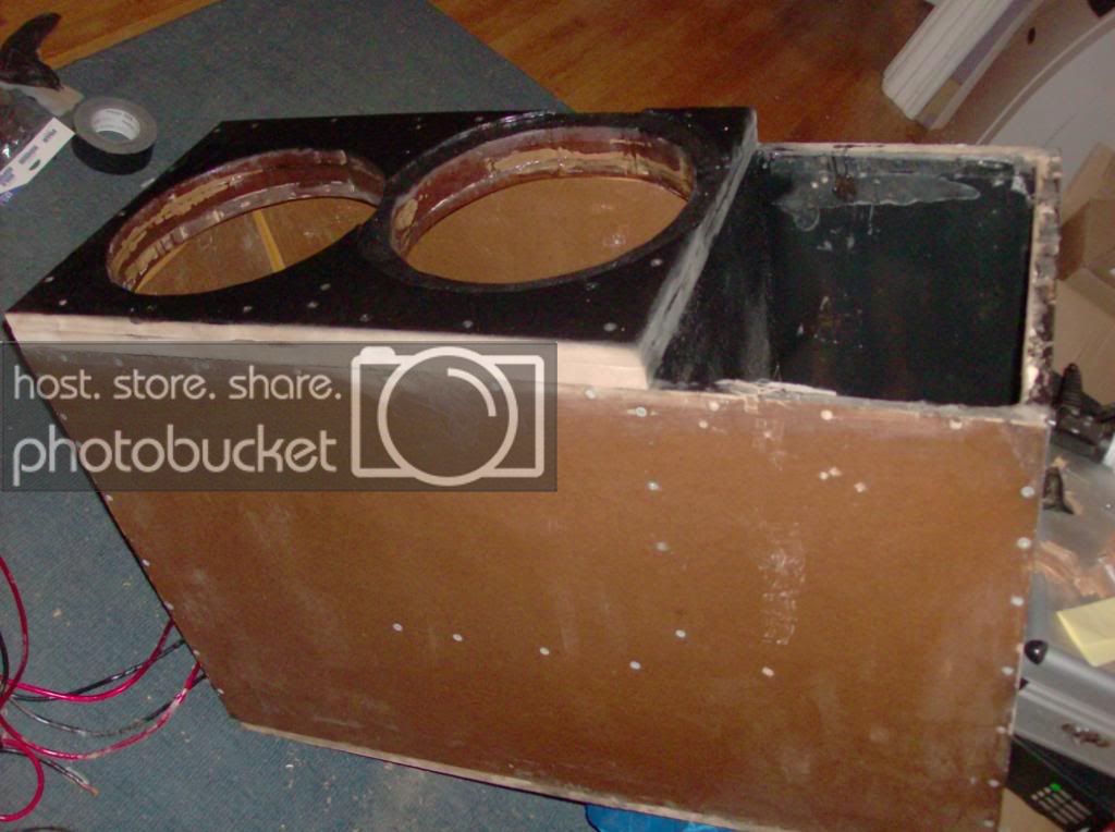

Getting finished. Will be ready to mount subs and call in some help to lift this thing back in.
Looks like you forgot to round off that inside baffle. //content.invisioncic.com/y282845/emoticons/crap.gif.7f4dd41e3e9b23fbd170a1ee6f65cecc.gif
Brotha I went after it like a champ but I ran out of room literally. The sides are less then .25 from the cut outs. However I did look at how much room is there once the sub is in and I have more room around the sub than a standard 10in cut out would give. This will be the second box with a triple baffle. First one did surprisingly well but overall was too big.
esplain pwease
I seal the box to the cabin deep within my trunk. The top extends 12+inches as well as the side. Once put together it becomes one big port.//content.invisioncic.com/y282845/emoticons/biggrin.gif.d71a5d36fcbab170f2364c9f2e3946cb.gif

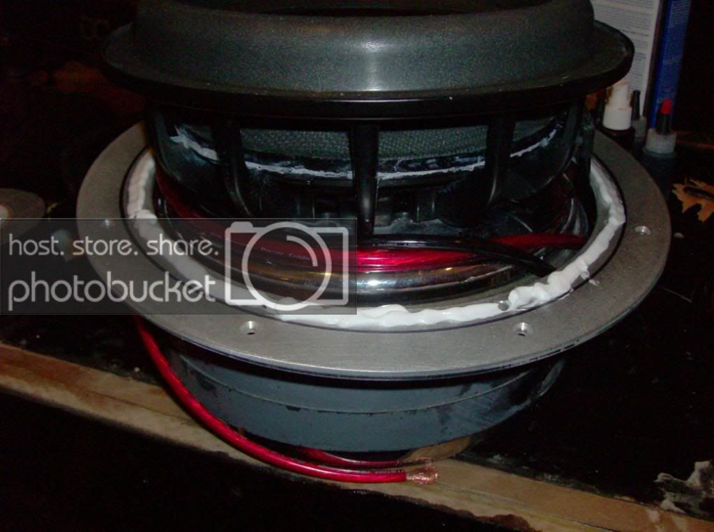

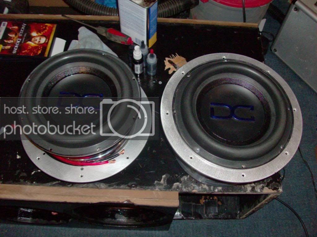

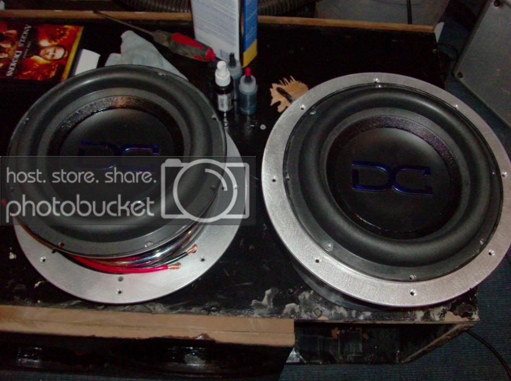

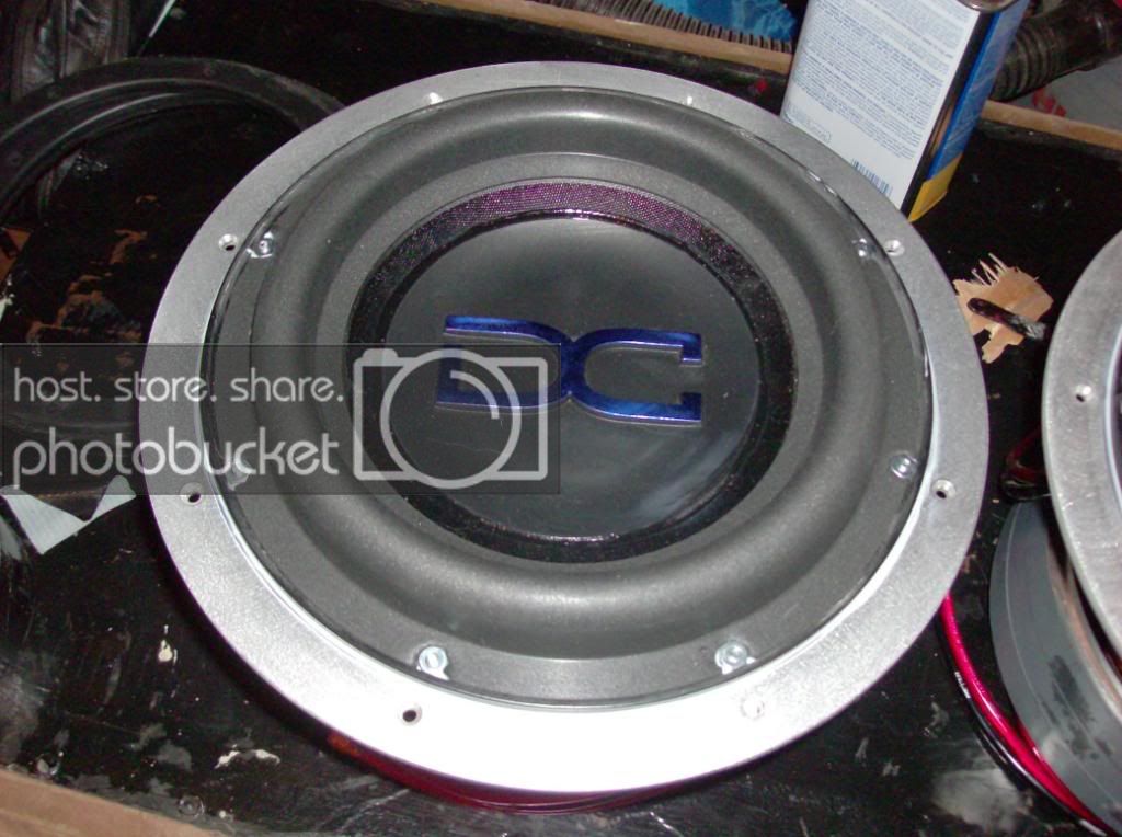

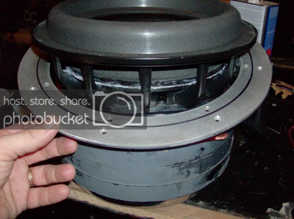

Finally sealed up the rings. Used #10-24 x 1/2" nuts and bolts. I chose to do the bolts top side cause the lock themselves in with the basket. At the same time the nuts also act as a lil more strength holding the surround down. //content.invisioncic.com/y282845/emoticons/smile.gif.1ebc41e1811405b213edfc4622c41e27.gif

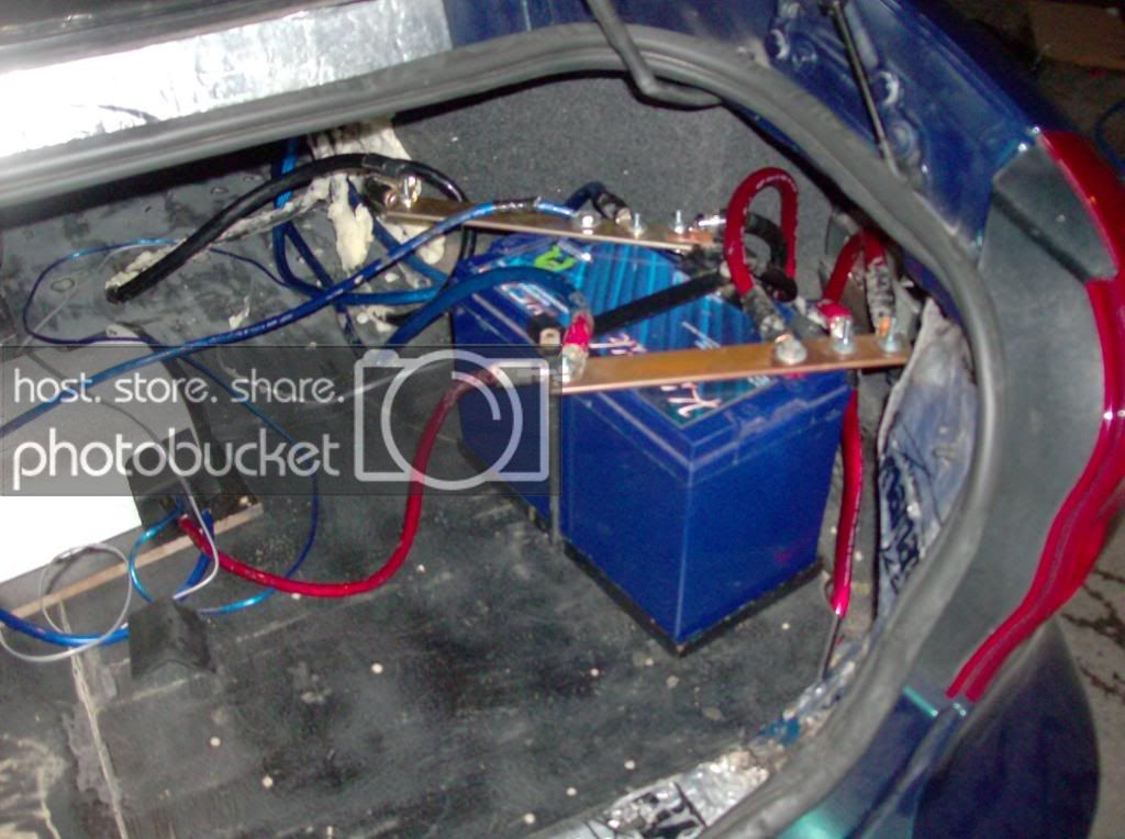

Updates on amp situation?
Still have my 18v Stetsom 14k2d running great //content.invisioncic.com/y282845/emoticons/biggrin.gif.d71a5d36fcbab170f2364c9f2e3946cb.gif Everytime I get in the car and turn the key amp comes on and I beat down the road. lol (of course i dont have the amp hooked up right now. lol)
