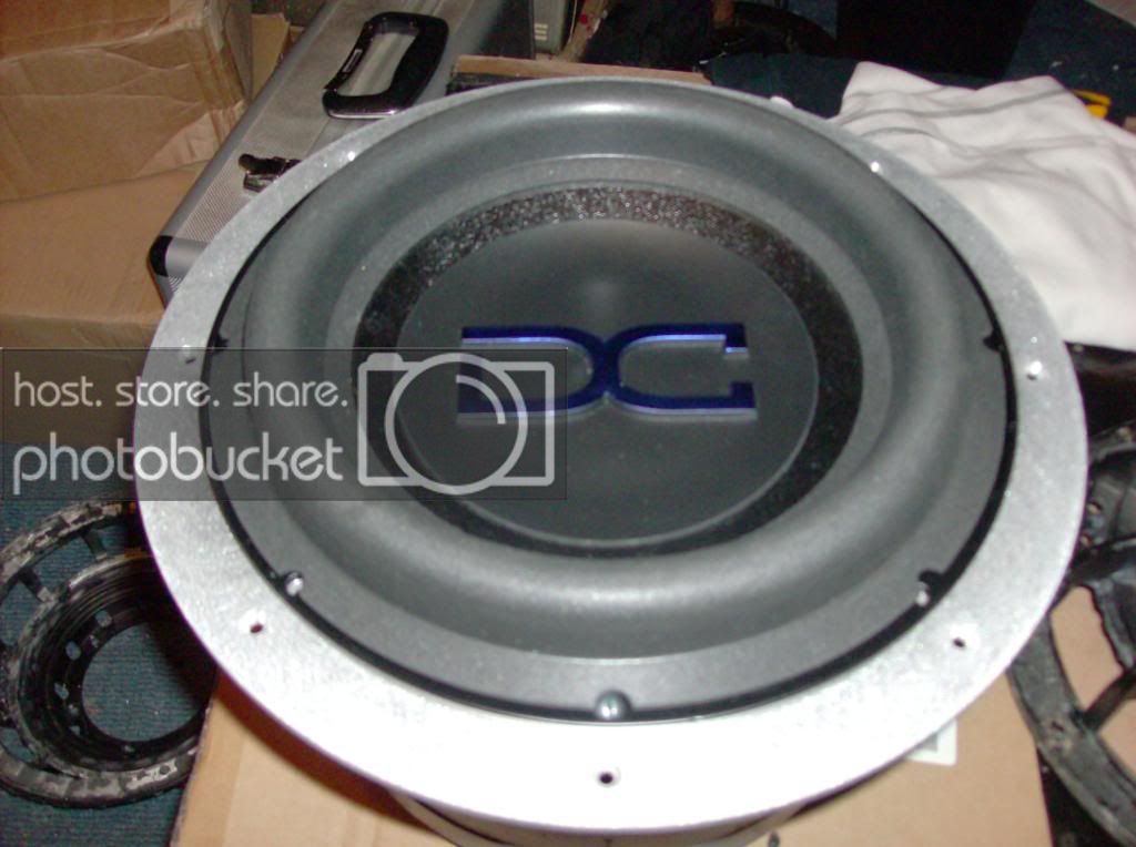

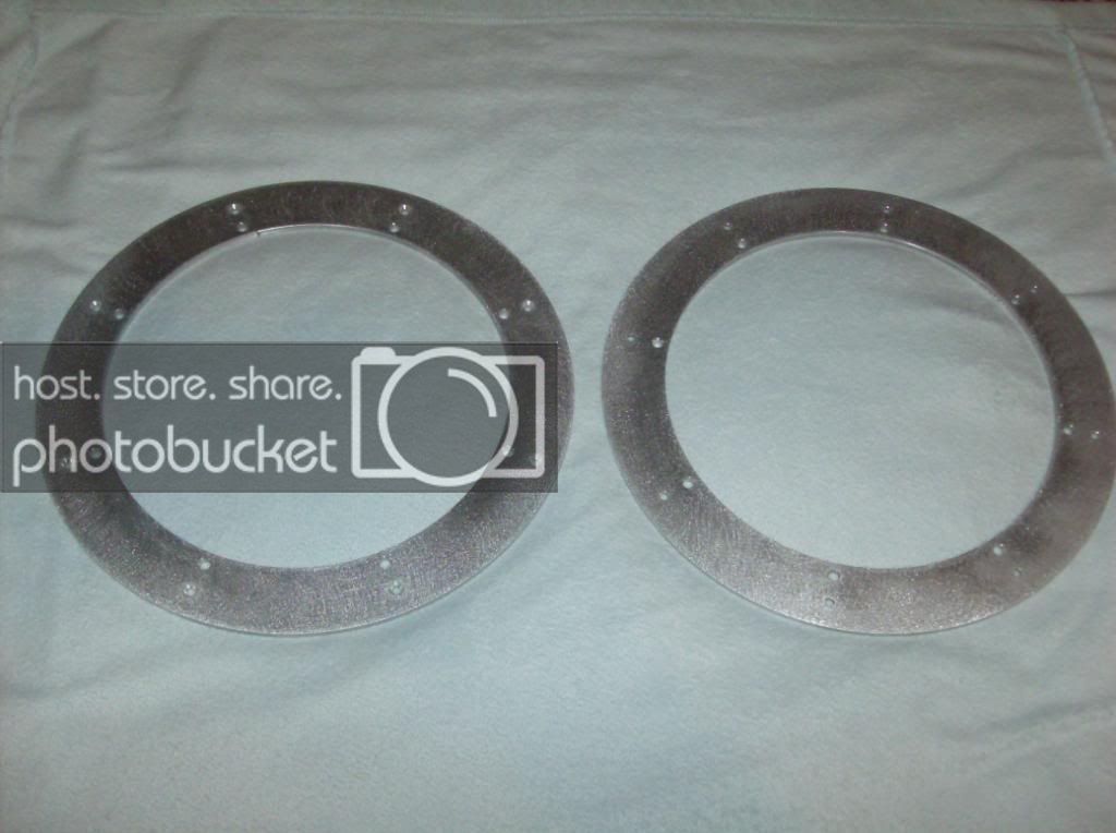

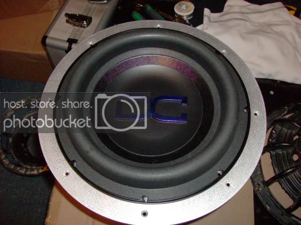

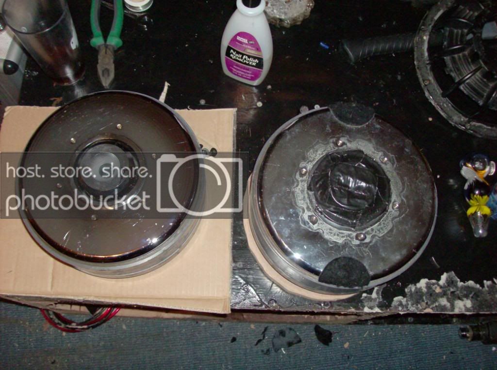

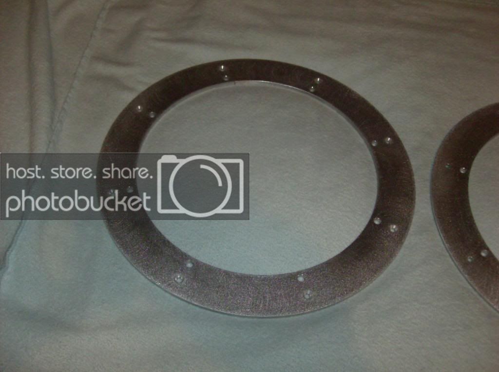

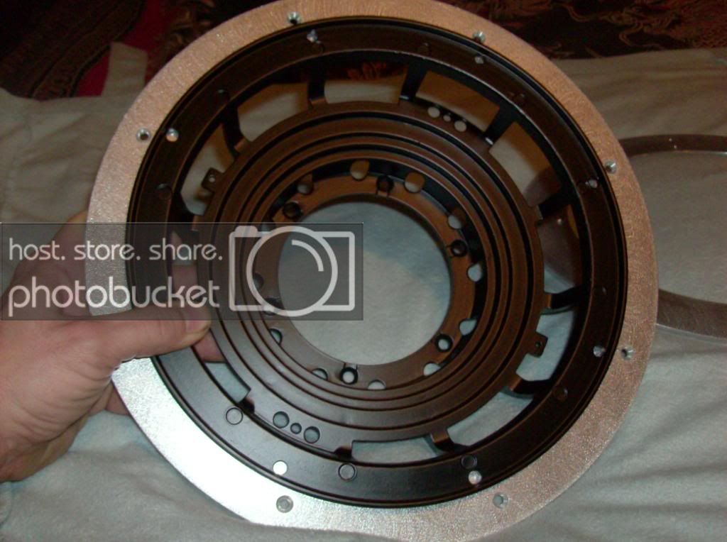

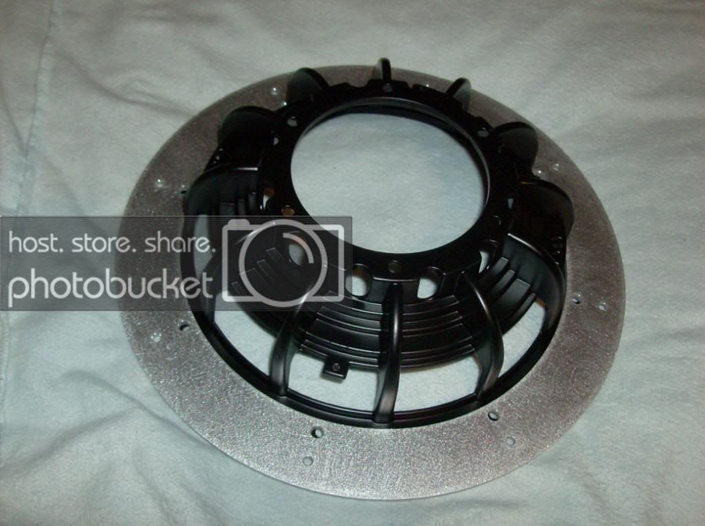

I finally got my rings and new baskets! Reconing will commence immediately!

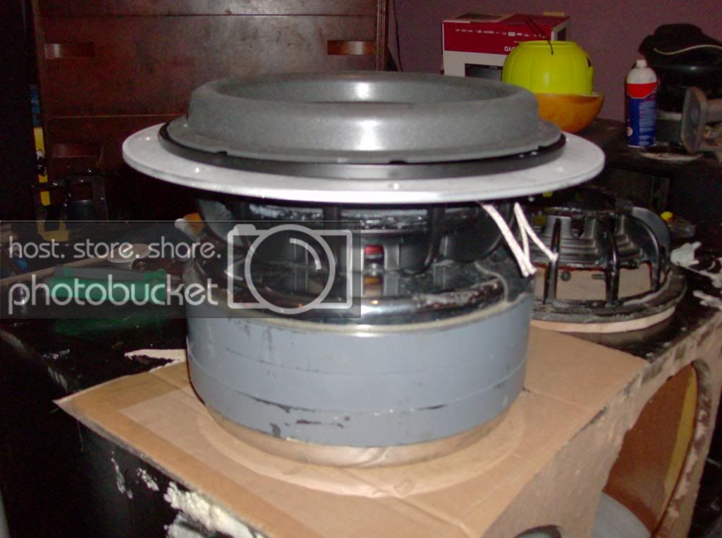

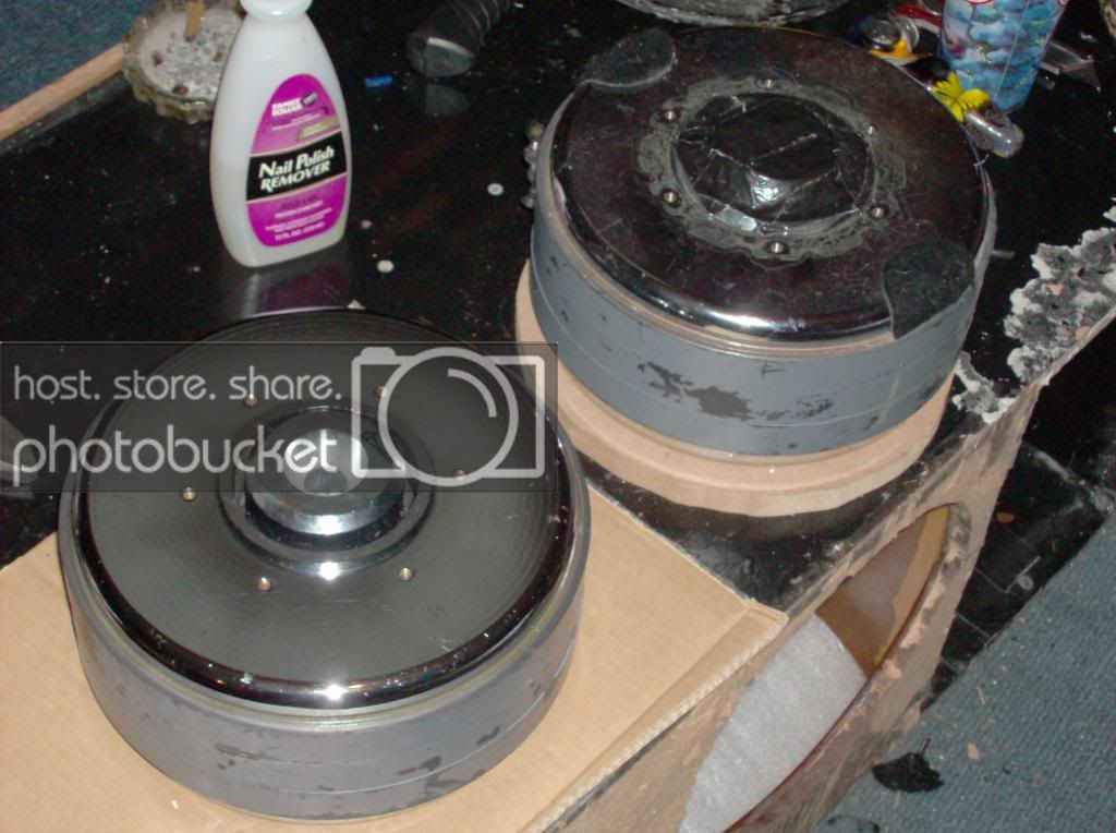

Couple more pics for ya
I gotta get some new screws for the basket and pic up some for the mounting ring as well.
Robin.. The answer to your question about whether or not the surround sits flush..no it does not. Probably sits 1/8in above basket when seated. That could be a spider thickness issue. lol Rusty and I both agree we will be going back to 5 spiders on the next set. We may pick up some efficiency who knows. We're also gonna try some flatwound tinsels cause I keep ripping them from the spiders. //content.invisioncic.com/y282845/emoticons/smile.gif.1ebc41e1811405b213edfc4622c41e27.gif
would be interesting to see the difference between the large gap and smaller with a larger pole. Fun stuff //content.invisioncic.com/y282845/emoticons/biggrin.gif.d71a5d36fcbab170f2364c9f2e3946cb.gif
