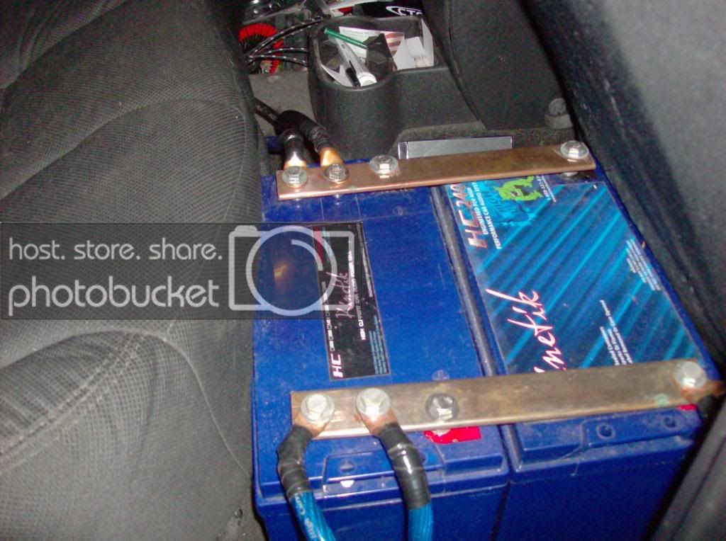

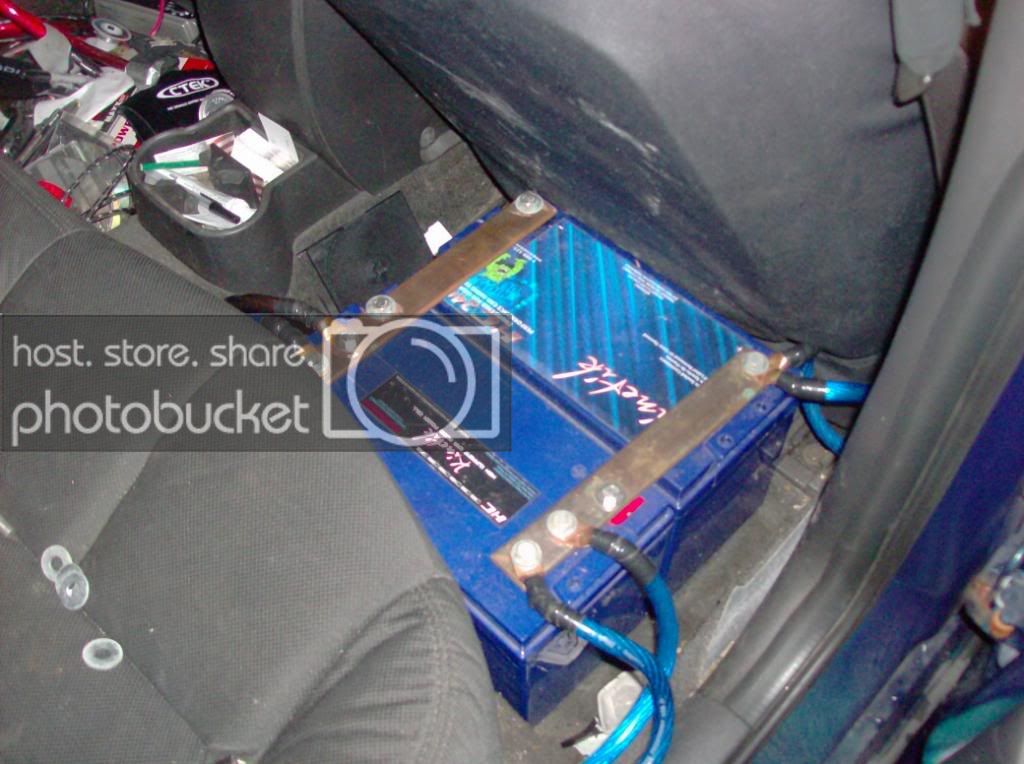

More clean up and added copper.

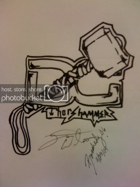

yo thor i was as hell tonight an remebered i told you about the thorshammer package so i want you to check it out bro its just a rough draft just thought i would share it with you an the rest of guys on here. let me know what you think an give me some insight on what you think will look better. i was also thinking of doing something like this again but with the hammer behind the dc logo will have it on paper if you need a look at it.
oh with the pic
you run this daily correct?
No problems with charging? do you have an MLA module?
5 hc2400's correct?
Yes this is daily. Alts been in the car for right at 2yrs now. Currently charges 4 kinetik 2400's and 1 yellow top. Yellow top is leaving and will be replaced with a kinetik 2000 and I plan on adding 2 more 2400's.
No I dont have an MLA module. When in full charge alt puts out 15.4-15.5v. I would kinda like to try a module though just to beef up the starting voltage on burps.

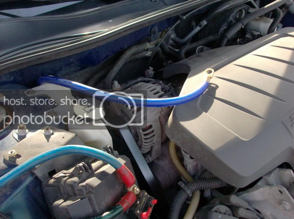

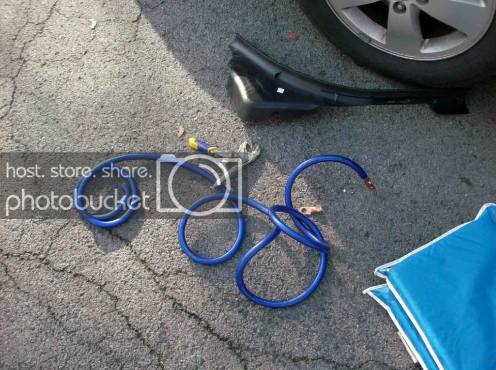

Spent all day adding another run to the car and ensuring that all batts see 3 + and 3- leads. The GP now has 3 runs of 0 //content.invisioncic.com/y282845/emoticons/smile.gif.1ebc41e1811405b213edfc4622c41e27.gif
yo thor i was as hell tonight an remebered i told you about the thorshammer package so i want you to check it out bro its just a rough draft just thought i would share it with you an the rest of guys on here. let me know what you think an give me some insight on what you think will look better. i was also thinking of doing something like this again but with the hammer behind the dc logo will have it on paper if you need a look at it.oh with the pic
That my friend is Perfect! Exactly what I was looking for!! You are the man and this is being forwarded to Rusty:D
is there a grommit in the passenger side you running the wire through?
I forgot to get pics but theres a wire harness that runs through the fire wall on the passengers side that has a beautiful rectangular grommet and size fitting rubber lock that worked like a charm.//content.invisioncic.com/y282845/emoticons/biggrin.gif.d71a5d36fcbab170f2364c9f2e3946cb.gif
alright cool. thanks.
