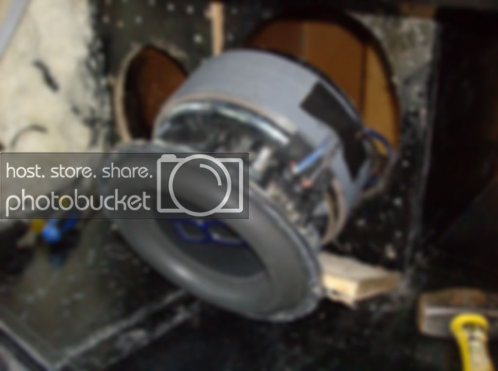

That is BRUTAL!!! The surround is crumpling at every frequency you throw at it. You must really be sending it some power.
EDIT: Duh, how did I miss that... Just realized only one sub was hooked up? That would make it way to big of an enclosure for just one, so no wonder. Plus since the other sub is sitting idle acting like a passive radiator making the sub think it's in even BIGGER of an enclosure. No wonder that thing was about to fly apart LOL!

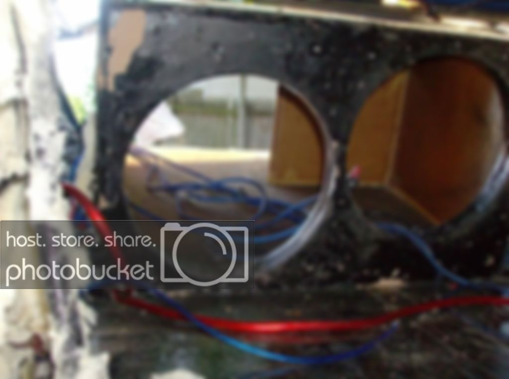

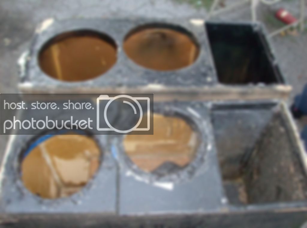

Pulled box out. Will build new box Sunday.
