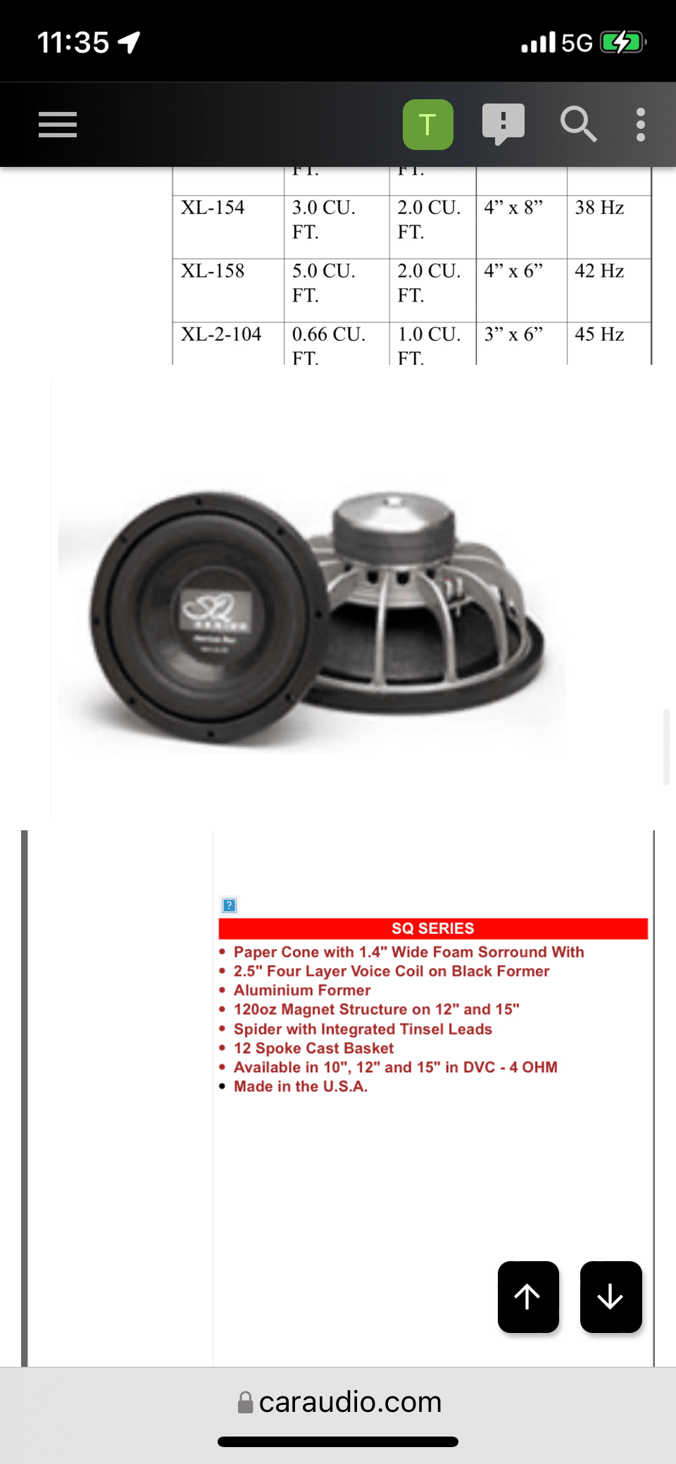

Some help from audiobahn let me know how old my subs are. 2004 American bass sq1244. No specs for these subs. I have a pair in a ported 3.05 net tuned to 32hz. I’m wanting to build a 4th order but maybe a single 12. What are some good options? I have a apcle1800.1d audio pipe amp. Budget wise maybe 200 for a single and 300 for 2. 2009 ford fusion
33 wide 14.5 tall and 26 deep is what I want to give up in my trunk. I would use my current subs but without any specs it’s gonna be tough. I have no internet at home or a computer for that matter.

I was thinking maybe the xd series similar magnet size and same surround and voice coil 2.5
