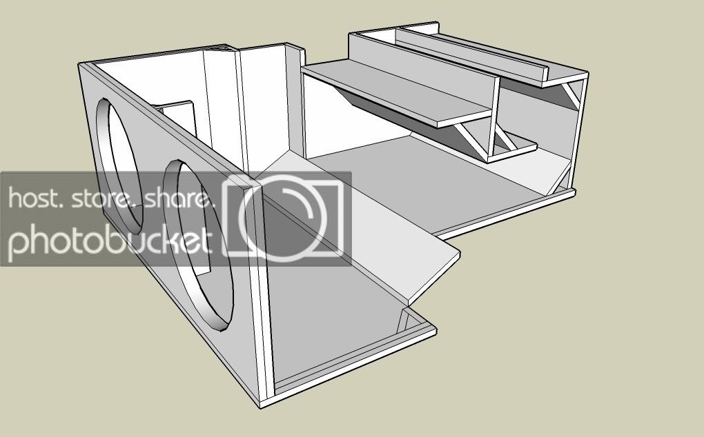

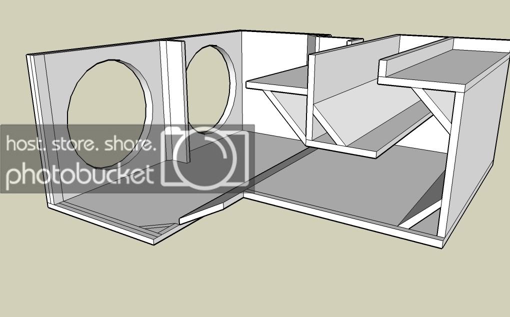

And just to post some pretty pics...here's what I came up with for the final enclosure design..
box will only add about 150-175 poinds, and idk about those subs.
itll be like having a fat guy in the back.
glad to see that you went with a double panel, wish you could all around, but i understand space constraints
box looks like a ***** to build though....lol
have fun
Thanks guys and the enclosure really hasnt been too hard to construst so far and the port has proven to be pretty easy too with this jig...I'll just be sure to countersink them as best as I can and fill in the holes to smooth everything out.
Rob, yea I'll be rounding over the port's corners //content.invisioncic.com/y282845/emoticons/smile.gif.1ebc41e1811405b213edfc4622c41e27.gif
And the port is about 8" from the rear window I believe...havent really measured it too closely yet.
