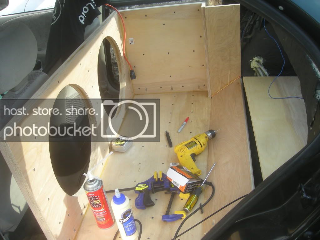

Alright, got a decent amount done today but not a ton..

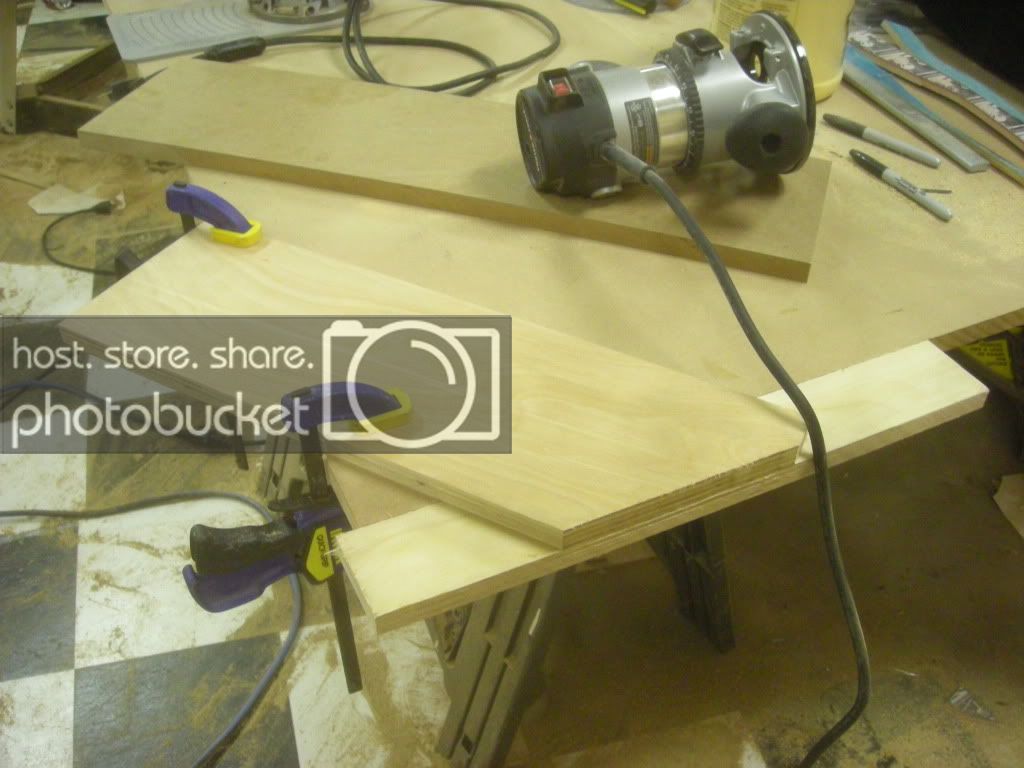

Marked a board to go on the side..the line is to be cut to mate with the angled piece (you'll see)
Screwed a board to it to guide the router to cut the line..
Bam..

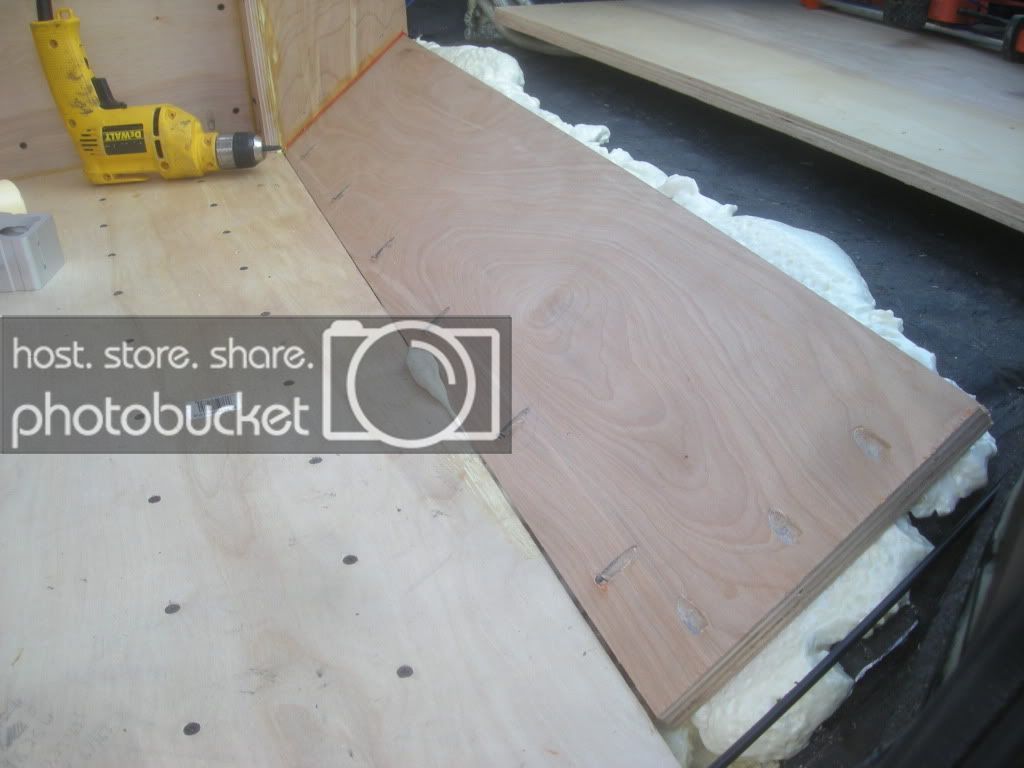

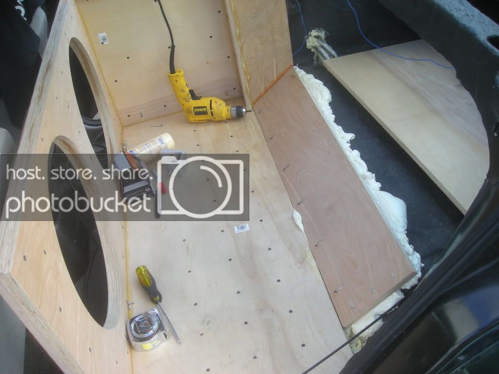

Mock-up..you can see the part of the wood that kind of got chipped-off and there's a slight gap, no worries...its going to be sealed and fiberglassed over

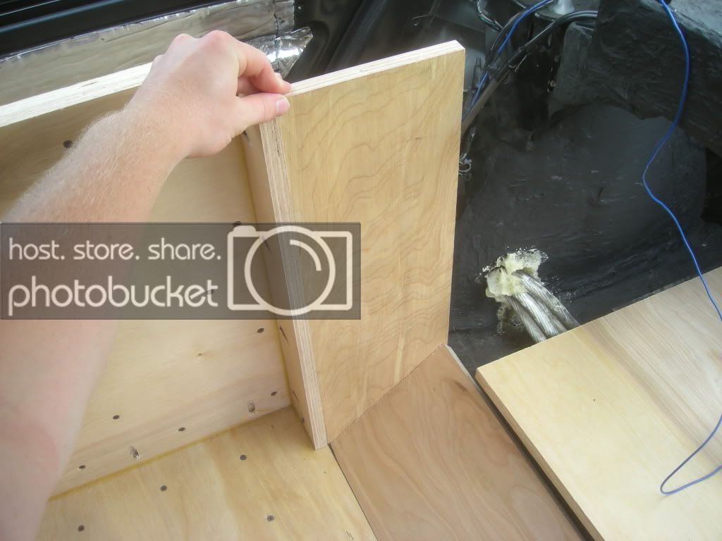

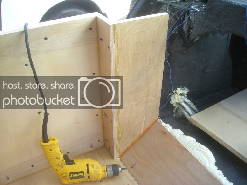

The other end of the angled piece will need holes drilled with the jig so I can attach the other side's side piece to it..
