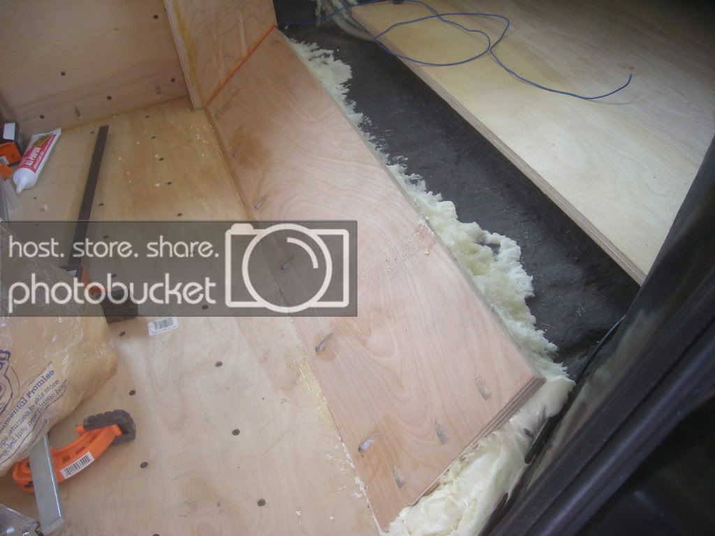

Toar out the excess foam-monster that was pouring out..

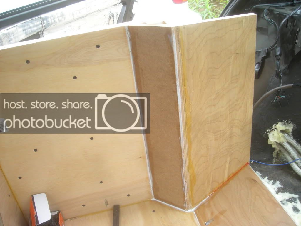

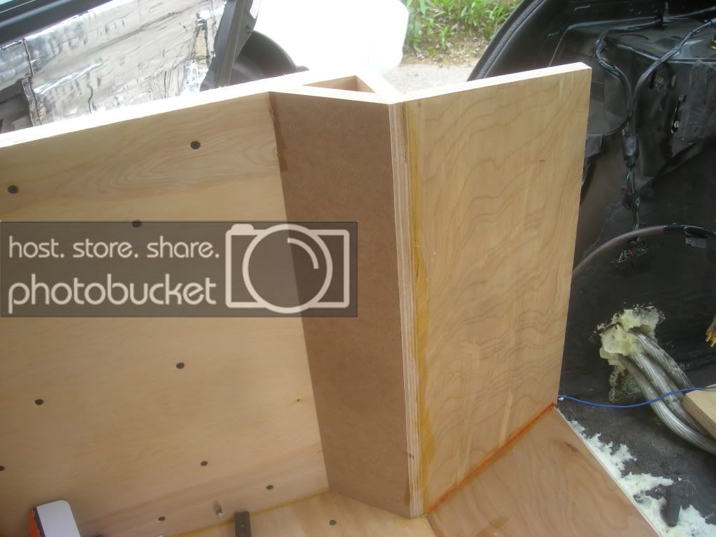

45 degree insert for the corner..
Sealed up..

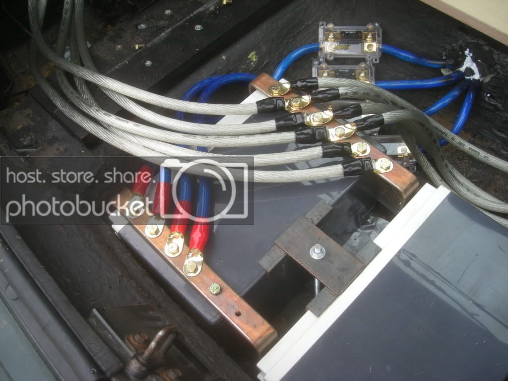

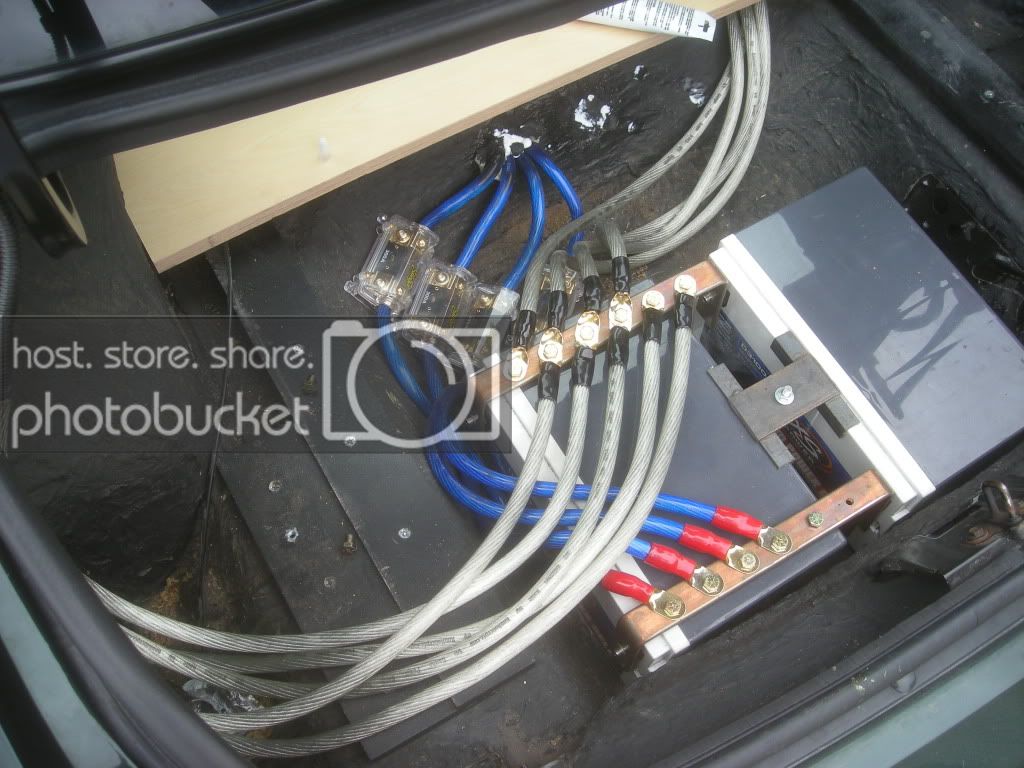

I decided the rear batteries didnt look mean enough //content.invisioncic.com/y282845/emoticons/cool.gif.3bcaf8f141236c00f8044d07150e34f7.gif..so I added some ground runs on the busbar to make future battery/amp upgrades a breeze (so that I dont have to try and get runs on the negative busbar which will have the port hovering over it...it'd be kinda cramped)

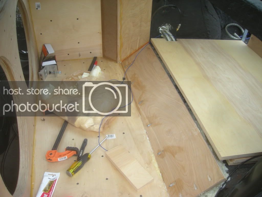

Some port pieces cut and layed out..
No pics after that because I basically sat down and started seeing what kind of port length I'll be getting with this and I may have to shorten the port a bit because im pretty sure it'll be tuned even lower than I wanted *gasp* with it like this...tomorrow I should be able to get the port dimensions settled and underway on construction..

nice nice, yah lets see how much it drops after puttin a heavy load on them dualies ;d or you got one isolated for only the audio load?
Nope, nothing is isolated...both alt's are hooked upto the front battery then connected to the back with the 4 runs of power and 4 runs of ground //content.invisioncic.com/y282845/emoticons/smile.gif.1ebc41e1811405b213edfc4622c41e27.gif
