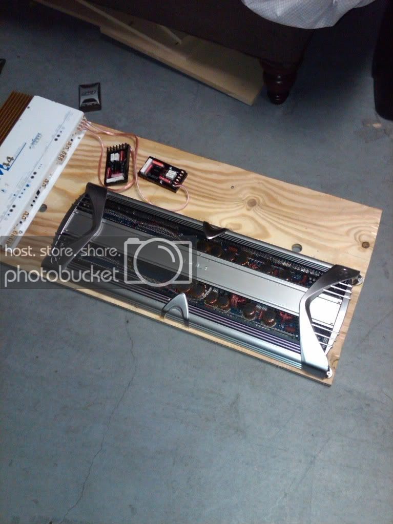

The monster has arrived pix!!
Should be ready to fire up the amp in a few days //content.invisioncic.com/y282845/emoticons/smile.gif.1ebc41e1811405b213edfc4622c41e27.gif

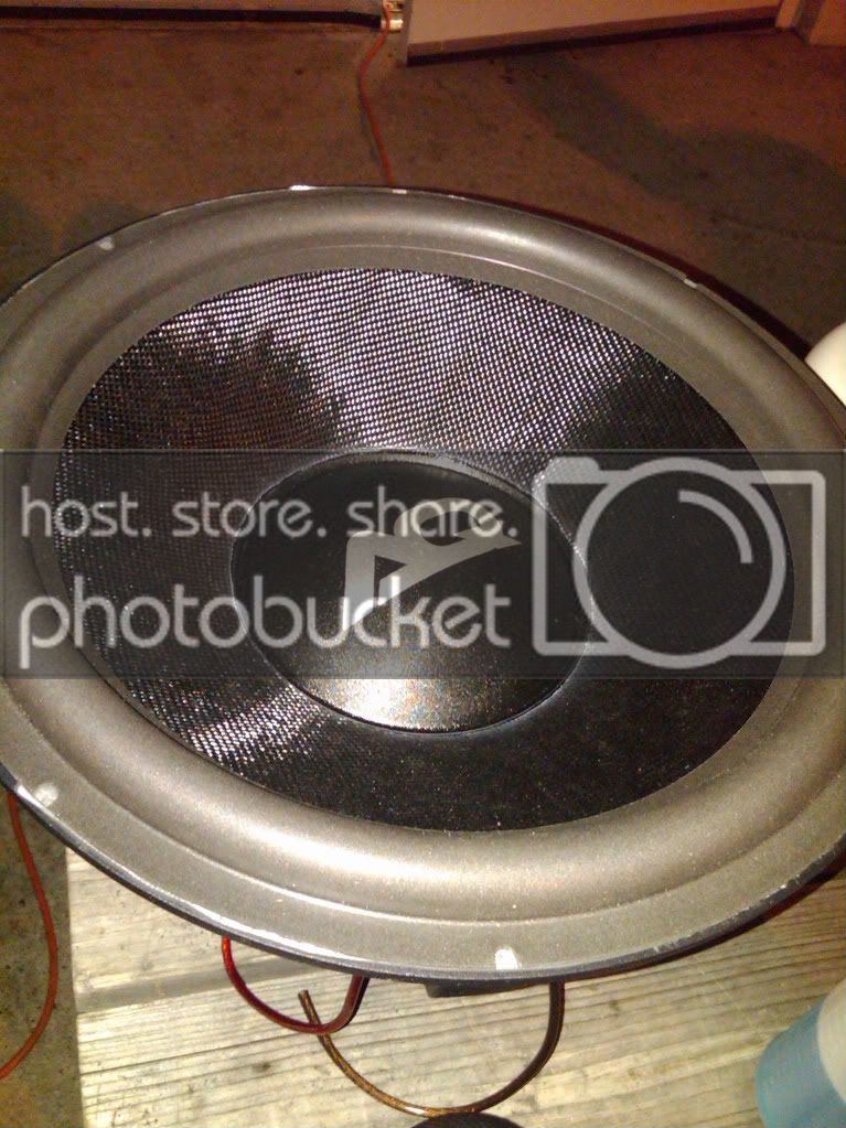

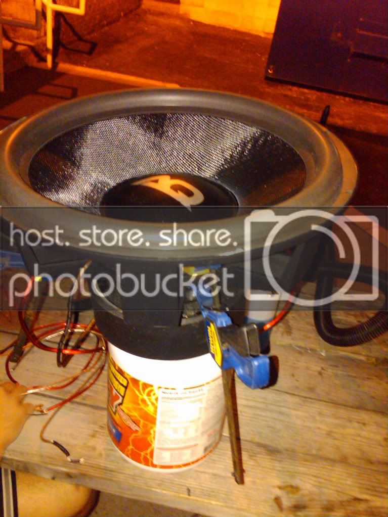

Really the hardest part of doing a recone imo is cleaning of da basket. Having a chisel, hammer, screwdriver and some type of grinding wheel like a dremel or drill have all been musts in my experience so far. It's imparitive that you get a nice clean surface for you to glue the spiders and foam down.
I've seen and met some folks that use clips and clamps to help but(as per DJ's instruction) I just use hand pressure and activator. Don't be afraid of using to little glue on the spider landing it sucks azz when it lets go. LOL
Good luck
Almost forgot use gloves when glueing. Takes days to get it off your hands. //content.invisioncic.com/y282845/emoticons/biggrin.gif.d71a5d36fcbab170f2364c9f2e3946cb.gif

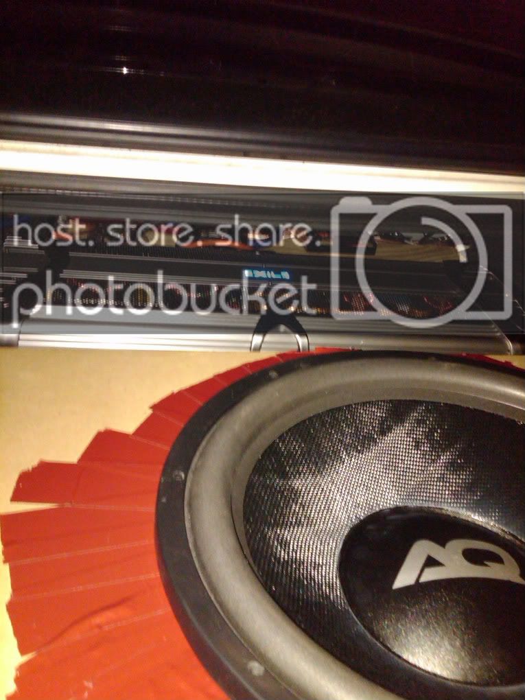

recone complete... amp in
this amp is a beast.. I am running it at 2 ohms right now, until I get my second 18.. Still got more 0 guage wire, and a batt on the way... Until that arrives, my electrical wont handle this amp at full tilt, even at 2 ohms very well..
Will keep this updated as more stuff arrives..
