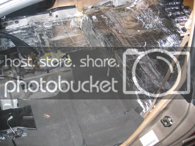

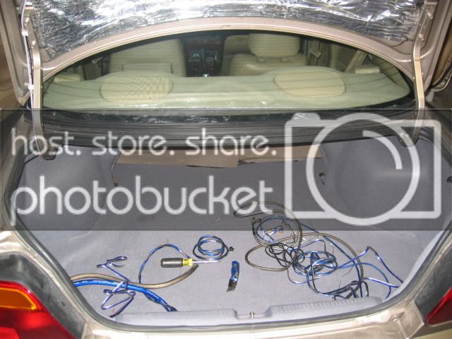

Well, I started the build 3 or 4 days ago. Man did it take a long time to rip all that shit out of my car and lay down the RaamMat. Here's where I'm at today. Today, I'm trying to mount my SS tweeters in the door, finishing the trim pieces, and going to get some felt to cover them in, and some plexi to cover the amp rack.

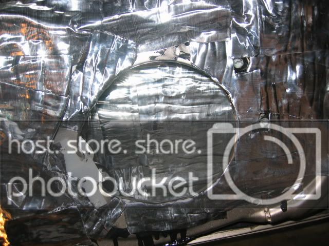

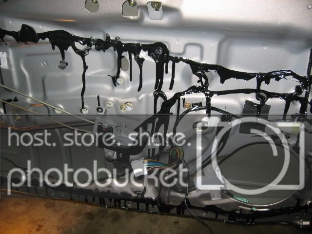

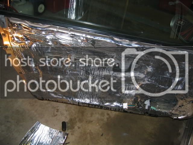

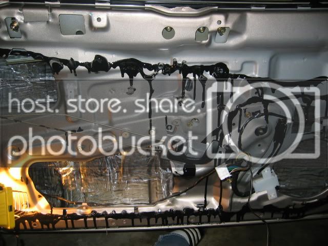

Drivers side door getting done.
Inner layer done.

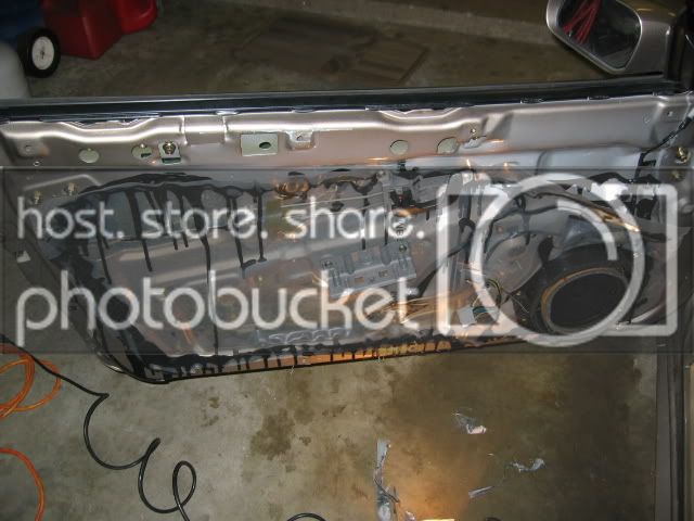

Outter layer + Sealed

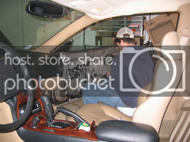

Buddy helping on passanger side.

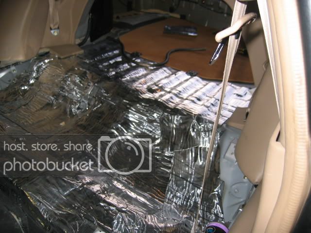

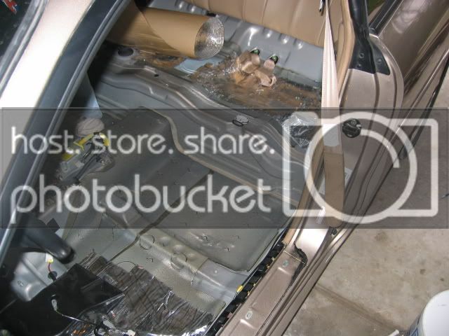

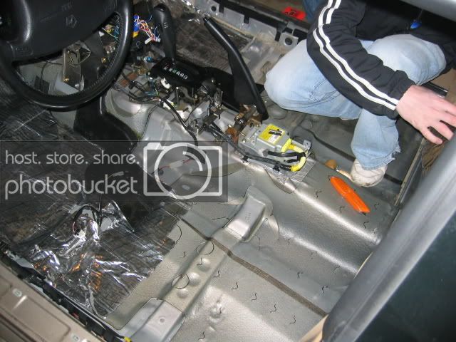

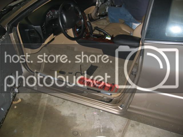

Now the interior came out. I didn't snap too many pictures of this process, but you get the idea.

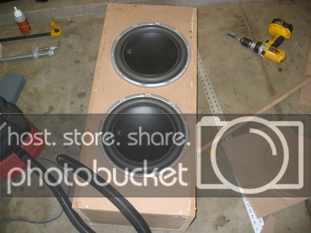

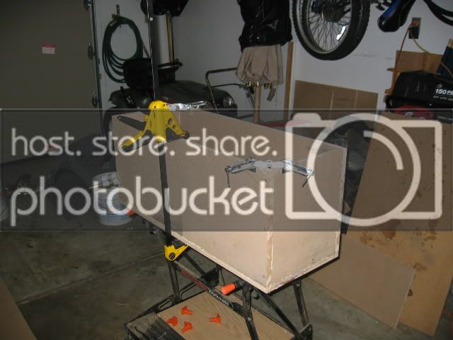

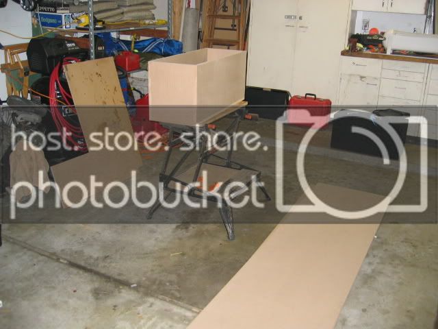

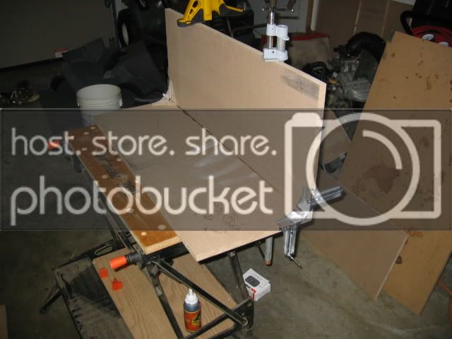

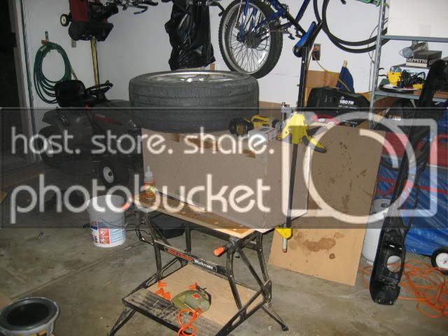

Box build for 2 12" W6V2's sealed. About 1.4cu ft a piece after disp
test fit
Used an LS rim I had laying around for some pressure

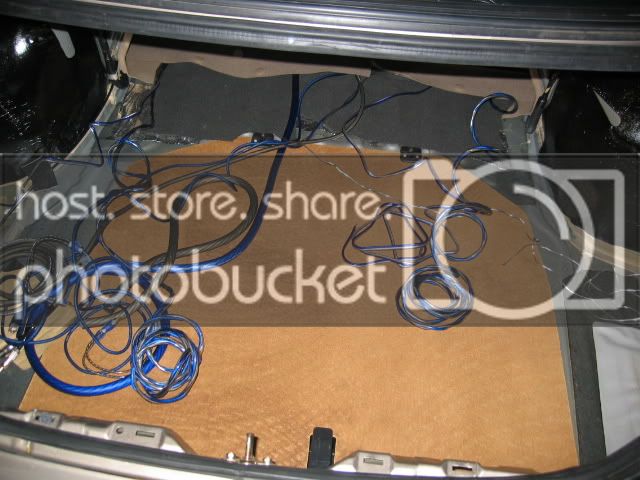

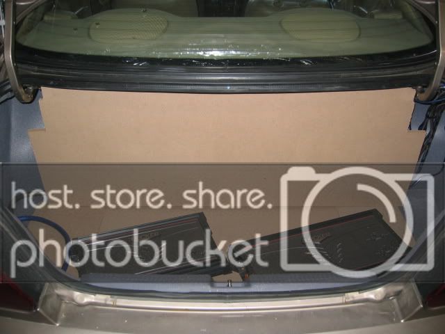

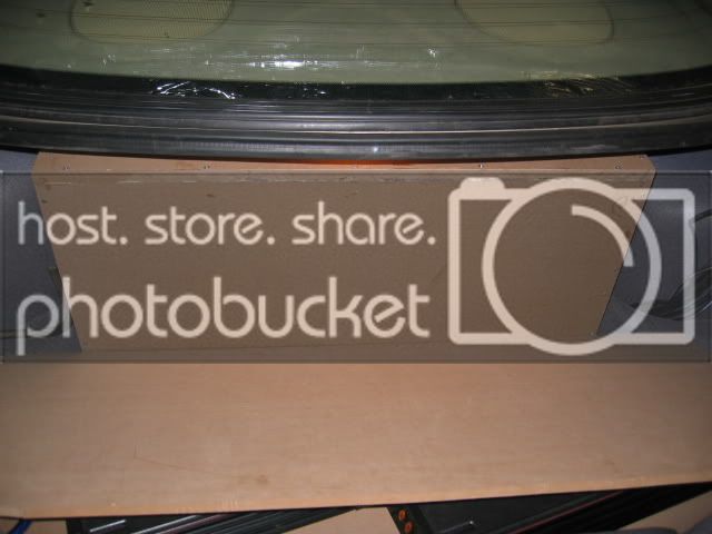

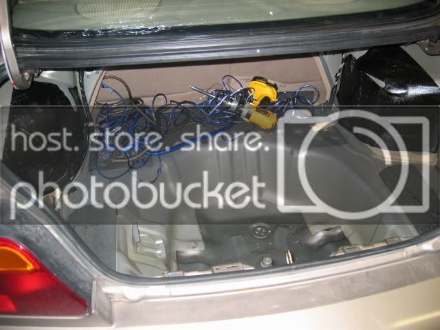

Started on the false floor/sub trim panel today.
Looks good so far

whatd you use to cover the big holes in your doors?
I put two layers of RaamMat backwards on the inside of the door, then two layers over the holes on the outside. Sealed it up really well, and was much easier than using sheetmetal/plexi.

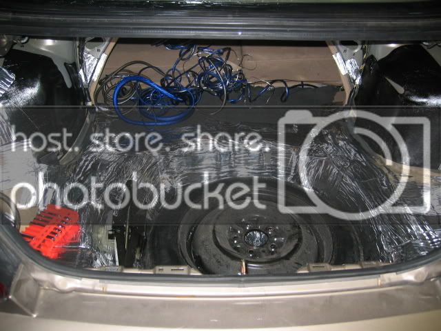

How much time do you think you spent deadning the floor? What was the hardest part of it
I'd say the hardest part is where I'm at now - making it all fit and look right so it's not a shitty looking install. The deadning was easy....just alot of labor. I think I started at about noon and worked til 8 or 9. That got both doors done, inside done and put back together, and trunk ripped out.
