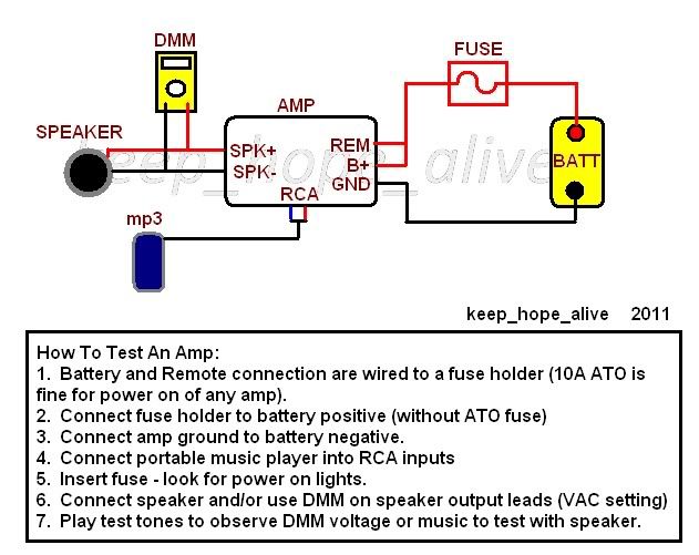

i made this for you
Hahahahaha I've seen that before //content.invisioncic.com/y282845/emoticons/biggrin.gif.d71a5d36fcbab170f2364c9f2e3946cb.gif
I literally drew that in the minutes before my post, from scratch in Paint, not referencing anything else. But it's nothing special and typical.
Wow for real... Not trying to call you on this at all - its extremely dam close to another I've see. I'll try to find it //content.invisioncic.com/y282845/emoticons/smile.gif.1ebc41e1811405b213edfc4622c41e27.gif
I can email you the paint file if you want. //content.invisioncic.com/y282845/emoticons/smile.gif.1ebc41e1811405b213edfc4622c41e27.gif I add a watermark on my diagrams. I don't care who uses them.
I'm sure this diagram has been done dozens of times before. I figured it would be faster to draw it than search for one that didn't ****. Hehe.
I normally use CAD so my lines are perfect. But paint was faster.
